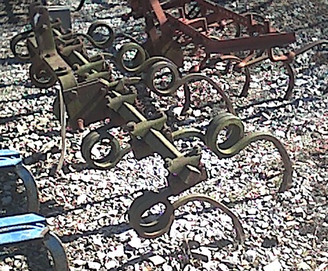

A machine such as this John Deere 9 shank ripper would do the job at $695 + shipping. Ken Sweet
