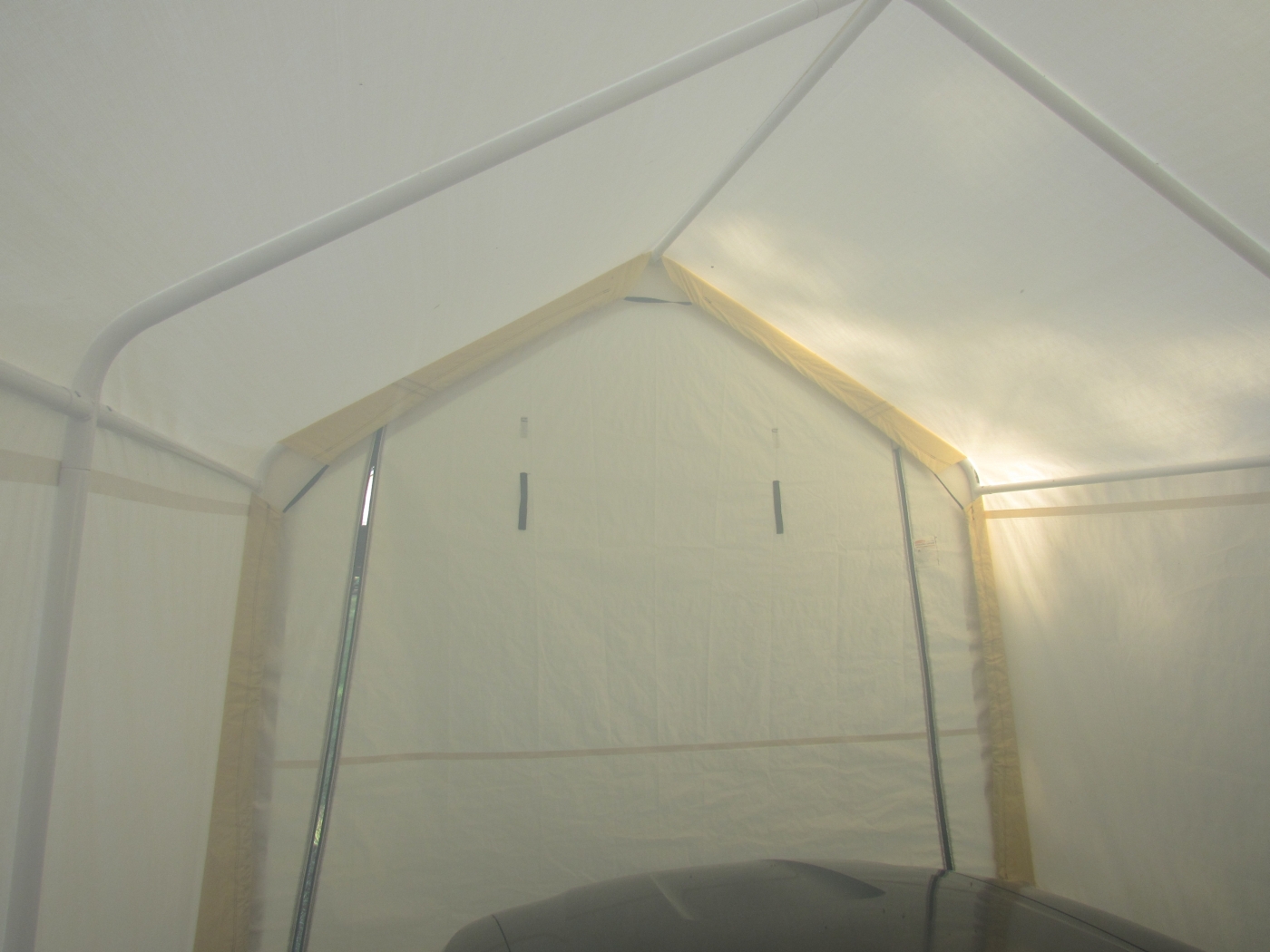

I recently purchased the 10x17 Harbor Freight portable garage. The door opening is about 90" wide at the bottom and 81" wide at the top. The door height is about 79". For the money I think it makes a decent temporary solution and should last a while. At least one review I read said the tarp cover was just showing signs of wear at 5 years old so that is a decent life span for a tarp. I purchased mine on sale for $179.99 plus tax. It is intended for a compact car but a medium size tractor should fit.
I bought it to keep my 1999 Mustang out of the sun. When my tarp fails I may cover it with roofing tin if the frame looks good. Mine has sat through a few blowing rains and showed no signs of damage or movement.

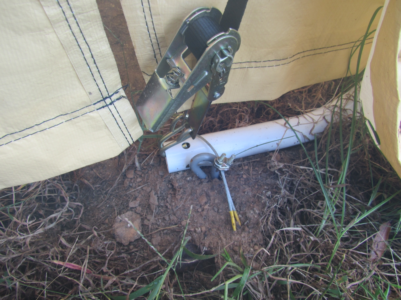

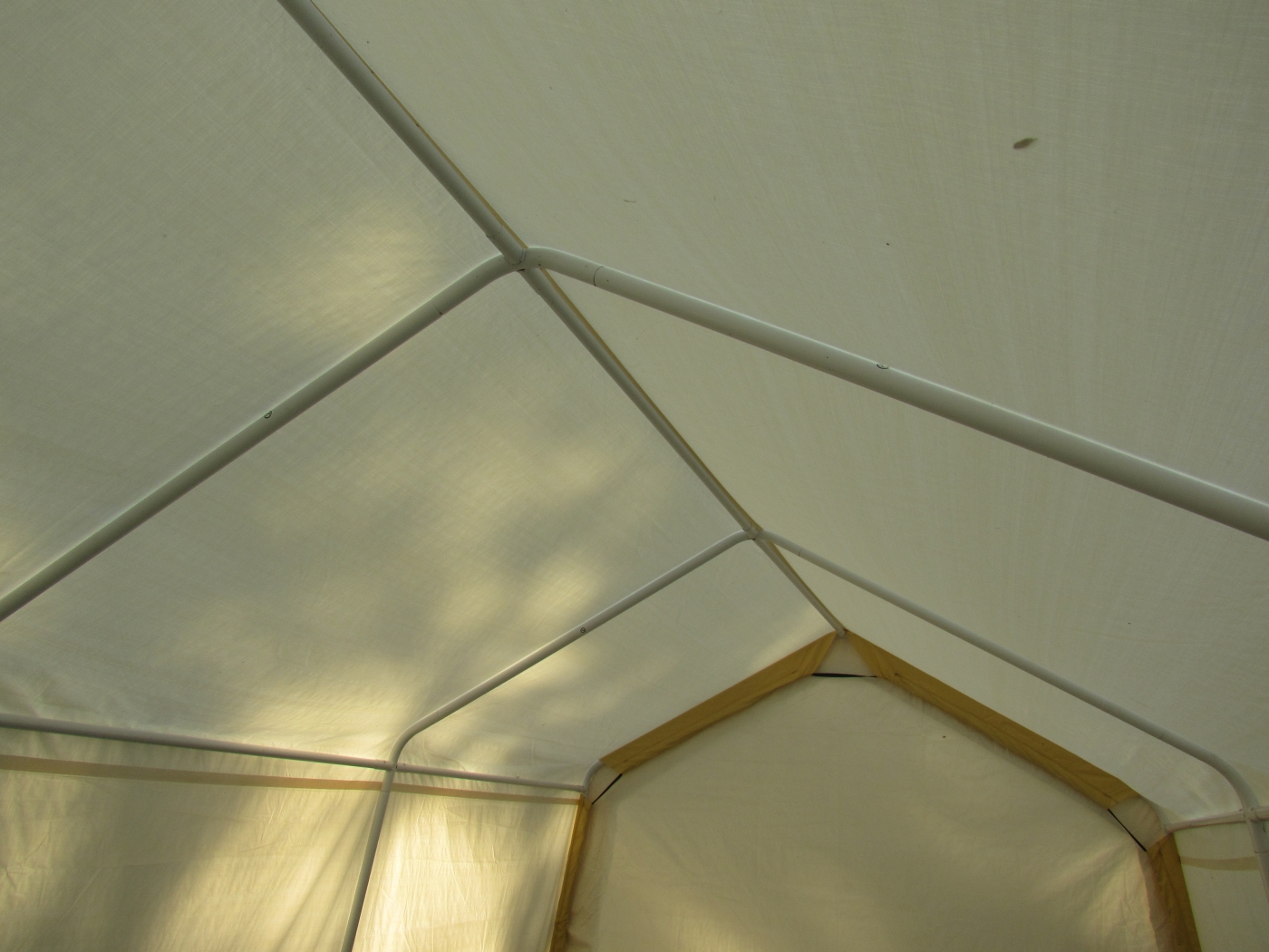

The frame is all 1-1/2" OD by .058" wall tubing. All the hoop and side pieces are of the same size tubing and they all join together with tee joints. Everything is numbered and is pretty easy to match up. I went a step beyond and ran a button head drill tip screw in all the joints to keep them from sliding apart during assembly. Some of the joints fit tight and some loose. I used a cone shaped muffler tool to straighten a couple of the joints but I could have managed without it. I used a 1/2" socket adapter with a 12 point 1-1/8" socket to screw the anchors in with a cordless drill. The supplied anchors screwed into my soil very secure.
I strongly suggest you have a helper to erect. The wife and I assembled mine in a little over 4 hours.
