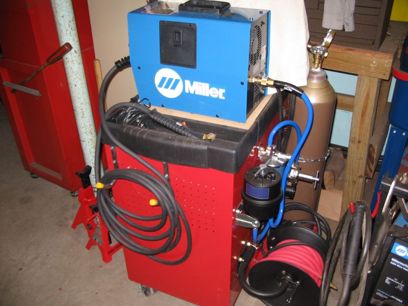

The specs on the HF unit fall between the Miller Spectrum 375 and Spectrum 625, although they are much closer to the 625 which is rated for 1/2". /forums/images/graemlins/frown.gif
So, comparing the 3/8" models (which is what the HF is rated at), the Miller gets the job done with less amps (27 vs 36) and a higher plasma flow (4.5 cfm vs 3.5 cfm for the HF).
The Miller calculates their rating at a temperature of 104 F. The HF does not publish this spec. It does make a difference.
Both need clean dry air to operate at their rated specs.
The Miller has a built in air pressure regulator while the HF does not. You will have to buy a dedicated external regulator to get your air compressor pressure down to 60 psi with the HF.
The Miller is more portable at either 110v or 230v.
The Miller is a transformer power source while the HF is an inverter.
The Miller will rated cut 3/8", quality cut 1/2" and sever 5/8" steel. The HF will rated cut 3/8" and they publish no specs for thicker sizes.
Consumables are much easier to obtain for the Miller unit (it's a Hypertherm torch).
The Miller has the industry's best warranty. I could find nothing about the HF warranty.
The HF has no track record regarding performance or reliability.
The Miller unit is built to take a beating with everyday use. The HF is for occasional light duty use.
Either unit will do the job (cut 3/8" steel). One does it better, while one does it less expensively. Only the buyer can assess the pros and cons of each unit as to how either will do the job he needs it to do.
