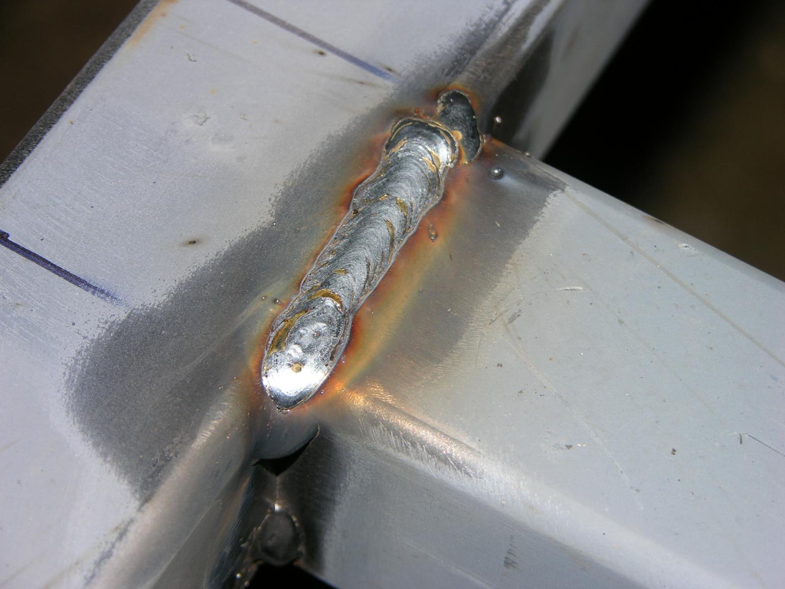

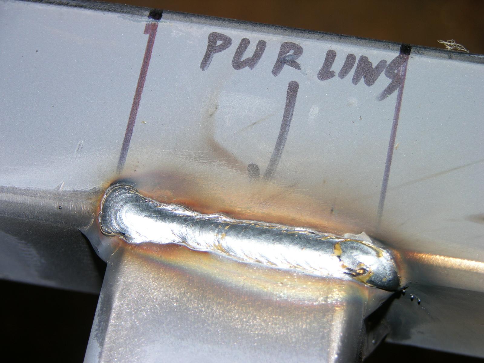

Amen - no cleanup on these at all -
DSCN2362.JPG DSCN2361.JPG DSCN2359.JPG C25 gas, .035 Lincoln L56 wire... Steve

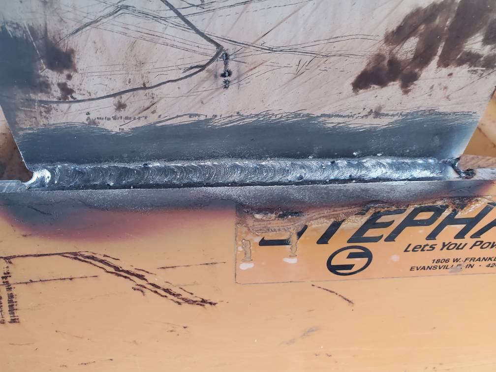

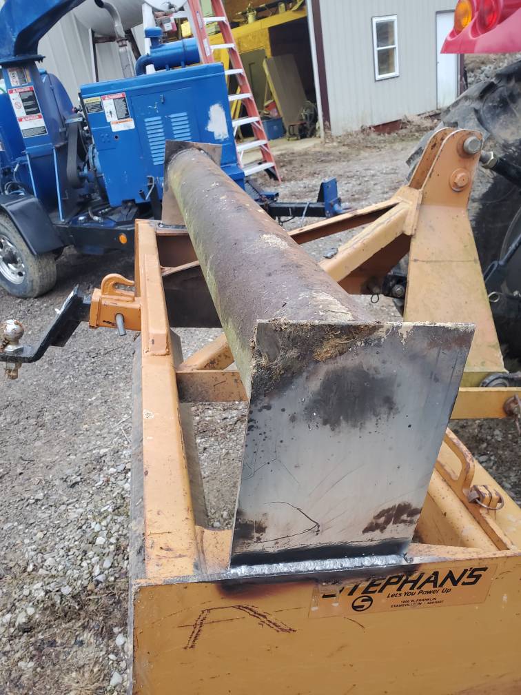

I disagree. I use both. When FC is dialed in just right the spatter isn't bad. I use FC for most of my dirty repairs and outside welding. I use gas when I'm dabbing fresh steel in the shop. I actually probably use FC about 60% of the time. Here are some pics from a recent project where I added a weight to my box blade. Flux core wire was Lincoln NR-212 .045.20200217_071148-558.jpg20200217_070217-789.jpg
