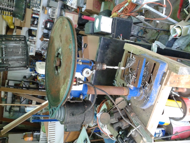

I bought a cheap harbor freight style drill quite a few years ago (Cummins brand) but found the speed to be too fast and the motor too weak to effectively drill thick steel so it sat around for quite a few years. The motor is only 2.4 amps (probably around 1/4 hp or less) and the lowest possible rpm combination of the belt on the step pulleys was 780 rpm.
First I removed the step pulley that was attached to the spindle. It had a 7/8" bore. I found a 16.5 inch diameter steel pulley on on old piece of farm equipment, removed it from its hub and carefully welded it to a 3 inch steel pulley with a 7/8 inch bore. It took awhile to get the large pulley perfectly centered on the small pulley so that it would spin true. I also flipped the step pulley on the electric motor so that the 1.5 inch step was on top.
I bought a 50 inch 3/8" wide belt for about $14.
Now the drill press has plenty of torque and cuts thick metal very nicely with nice long stringy metal "chips". I drilled a couple of half inch diameter holes in 1" steel (1/4" pilot hole, then finished with a 1/2" bit) and it did great.
