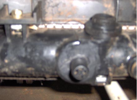

I also busted my radiator. Somthing hit it from behind at the bottom and busted the tit that sits in the rubber mount. I plan on seeing if another end cap is available that will work on my tractor. Any other suggestions would be appreciated. The attachment picture is of the piece that broke off.

Do you have a good radiator shop near you? In my area I would have it repaired. Such a shame on a new tractor, but we do buy our tractors to use them. Good Luck!

I just wanted to let people know that I was able to repair my radiator for three dollars with VersaChem clear weld epoxy system
I was afraid I would have to replace the end cap or even the whole thing. I used my tractor a couple of hours today with no leaks.
