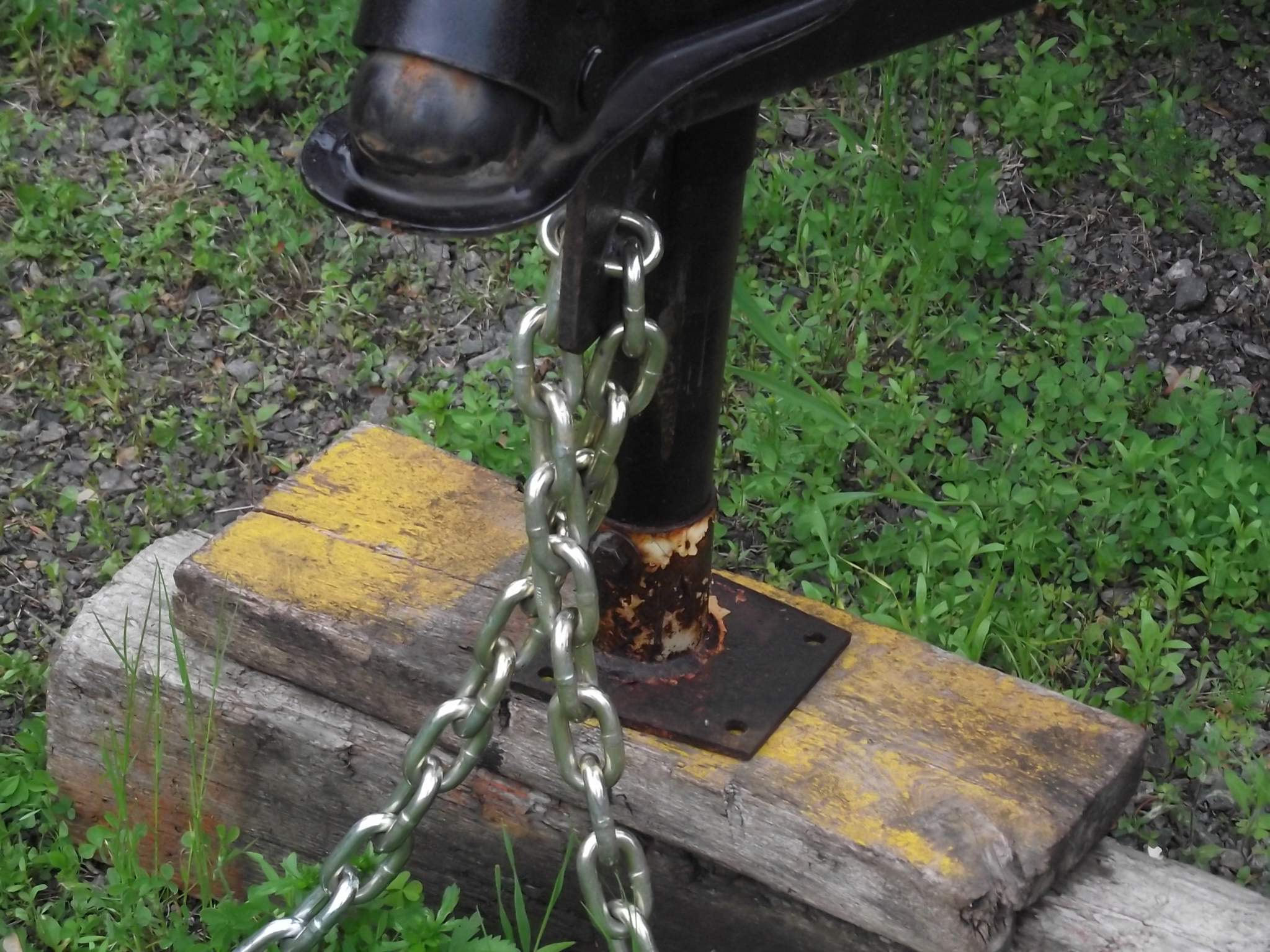

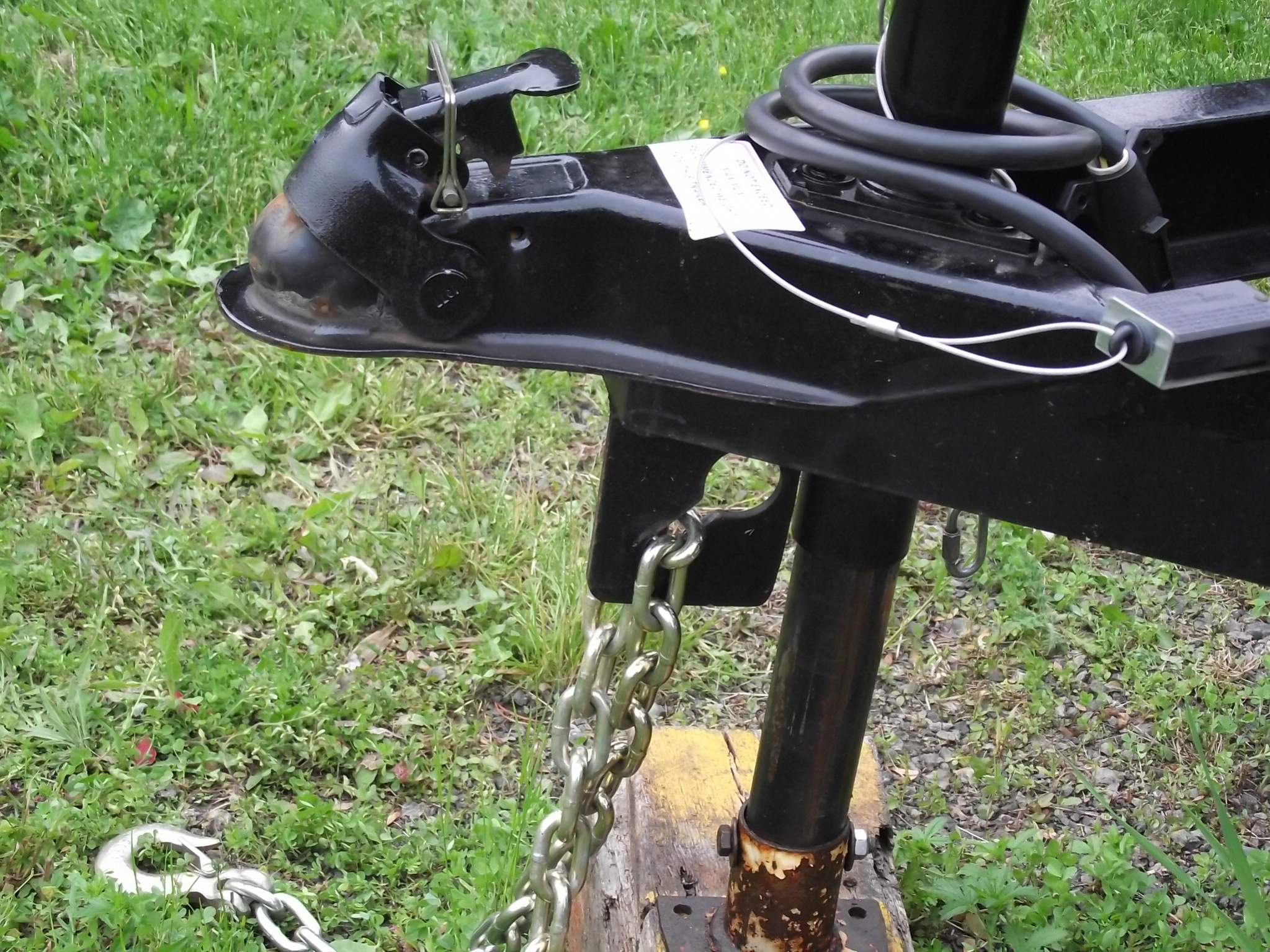

Here's how mine came from the factory in 2008. It's actually a single chain (with a hook on either end) anchored in a keyhole slot in a bracket welded to the front of the A-frame.
I wonder how hard that keyhole slot would be to cut.
