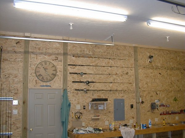

<font color="blue"> Eddie, do you think the wood will make it too dark inside the building? /forums/images/graemlins/confused.gif Or should he just paint the wood prior to installing it? And of course he would really need a lot of good primer as it will really soak into the wood. I wonder if some type of aluminum or vinyl siding might work better for the ceiling and wood for the walls. </font>
I don't consider our pole barn dark inside without painted walls, what do you think?

Pineridge's pic shows real good how OSB looks on the wall.
I left mine just like he did and have plenty of light. In fact, if you install the OSB with the shiny side facing in, I think it adds light to the space. The other, rougher side would probalby absorb light, but that's just a guess.
My current workshop is the first time I've done all the walls in OSB. It's also the best shop I've ever built and having the OSB has made it very easy to hang stuff from, organize and work in there. For me, I would never put anything else on the walls.
Eddie
