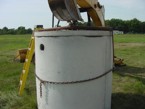

One of the advantages of having a welding machine is every now and then you need something now when only a something will do.
It's a ............

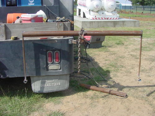

another angle

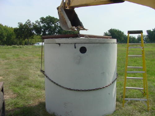

Saw the backhoe in the background and knew instantly what it is, right?

The boy at the septic tank place told me to be very careful handling that thirty five hundred pound five hundred gallon tank. "Break it if'n you want" he said. "It's yours".
So I whupped up a quicky that worked on the same principle as the professionals use. /forums/images/graemlins/grin.gif

Isn't that called a "strongback "?

I knew right away it was a spreader, but what I actually saw in the background was that truck body with the twin propane/butane tanks, and figured what you needed was a spreader to handle them. I couldn't figure the little pipes on the ends of the vertical rods because I figured you'd use hooks, but then I figured you just used whatever you happened to have on the back of your truck.
But, when I saw how you actually used it, you were redeemed in my eyes - those chain guides were exactly what you wanted, not just what you happened to have!
Your heart musta gone up into your throat a little, when that top pipe started bending!

The pipe lasted one tank. I replaced it with a chunk of I beam for the next tank. /forums/images/graemlins/grin.gif
