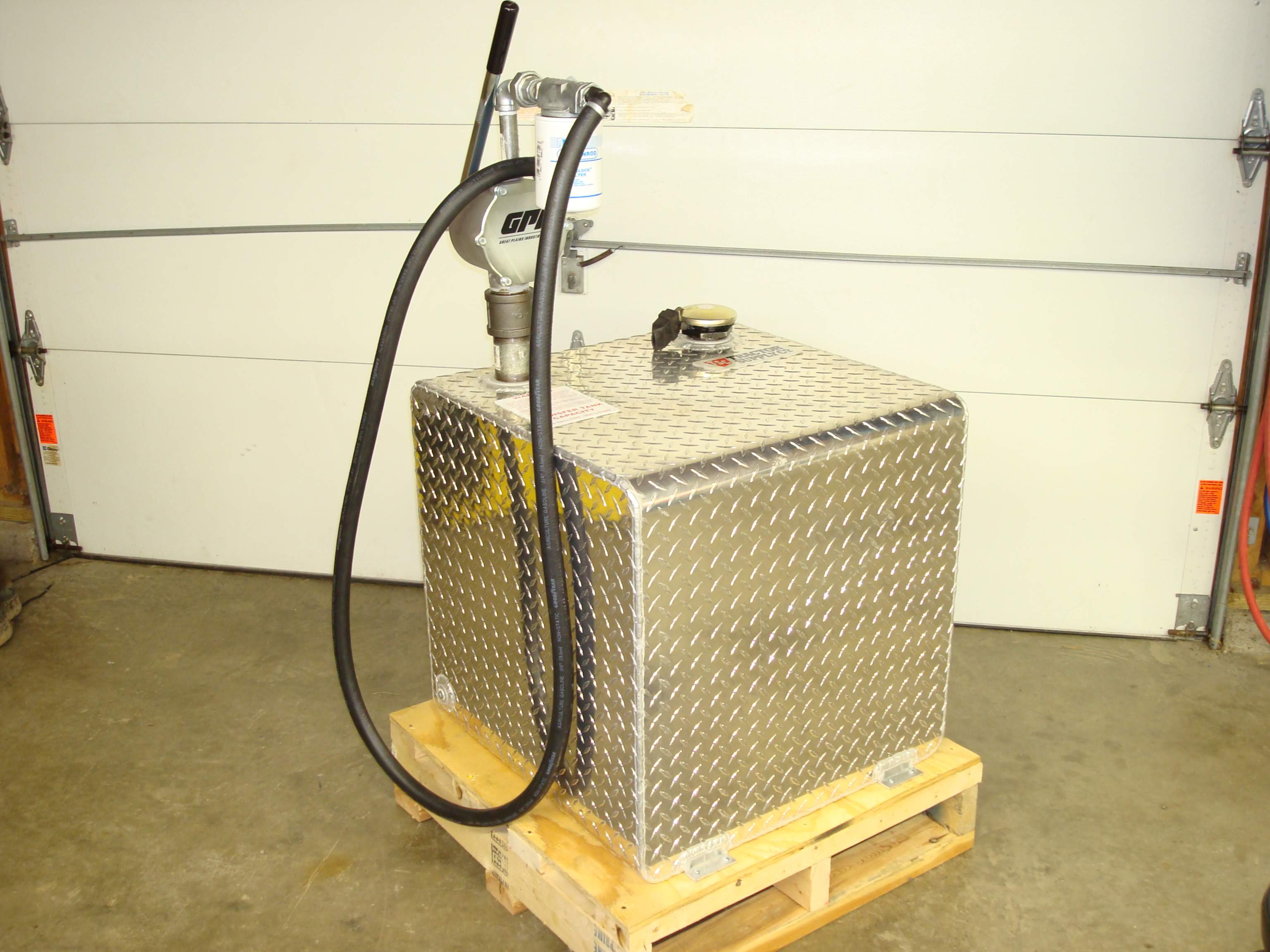

I have two 50 GL tanks with hand pumps. One gas and one diesel. They are on pallet skids. When empty just load min the PU with the FEL forks and go fill at the pump then unload at home. They are a max lift for my BX25. Fuel never gets contaminated and pumps through a 10 micron water absorbing spin on filter. Each one is a $350 investment, sure worth it.
