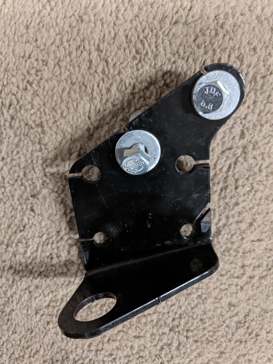

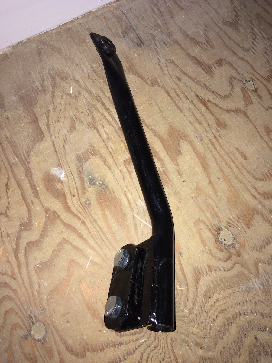

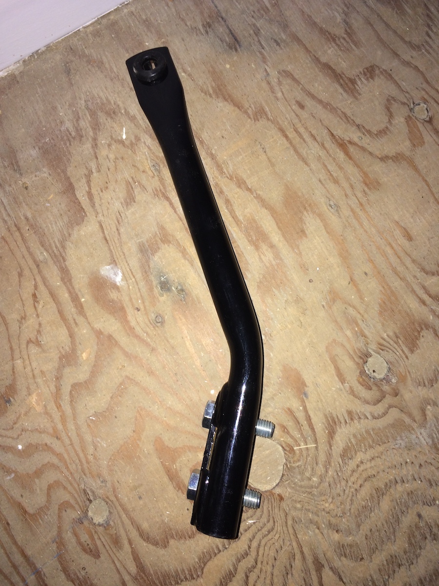

I just got my 2360 and the dealer sent the wrong bracket at first. My manual only covers the 2300-2400-2600 series and even then, there are three different brackets shown in the manual. The one I was originally sent was not even one of those three.
I think with this stuff, a dealer call is the fastest solution. I'll post a pic of the one I got originally below, see if it looks like the one..
View attachment 630295 . View attachment 630296
This one fits a 1723e, with a loader frame.
I know this because the used 2360 I bought was mounted on a 23xx series and the bracket that came with was not right. The other long bracket in the parts book is not right. The short one was right.
Without the loader frame though, I do not know.
   / Handle support bracket for my 2360 snowblower won't fit #8
I guess I should contact the dealer and send it back to them. Good identification.
