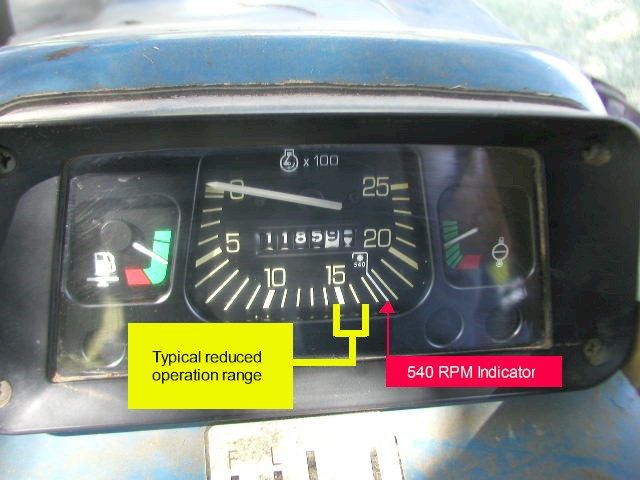

Thought I would ask the experts a question concerning my Ford -New Holland 3930 tractor. When bush hogging my 17 acres I have noticed that my 3930 does not stay at the 540 rpm indicator but slows down. In order to maintain the 540 rpm I have to manually increase the throttle. Is this normal or should the throttle stay at or very near the 540? Does this on flat land as well as hilly slopes. I probably understand why it would occur going up a slope but thought that flat land would be fairly consistent in terms of rpm.
Thanks for any info.

You will probably find that the rpm's will vary slightly as the stuff you are mowing changes. To a certain extent, the governor should adjust things to keep the rpm's the same. I tend to set the pto to 540 with the hand throttle at the beginning and then continue like that. If the rpm's drop a bit it doesn't really matter. If the engine starts to bog down then I step on the foot throttle till it gets easier again. I think what you are experiencing is normal. :)

It sounds like your thottle pressure plate needs to be tightened, or your spring is weak. That's what holds it in position when you adjust your throttle. You are overriding that when you hold pressure on your foot throttle.

I agree with ford 850. I believe your 3930 has a hand throttle assembly similar to my 7610s.. And I had to tighten the nuts holding the friction disc.. or mine would slowly loose RPM as well.
