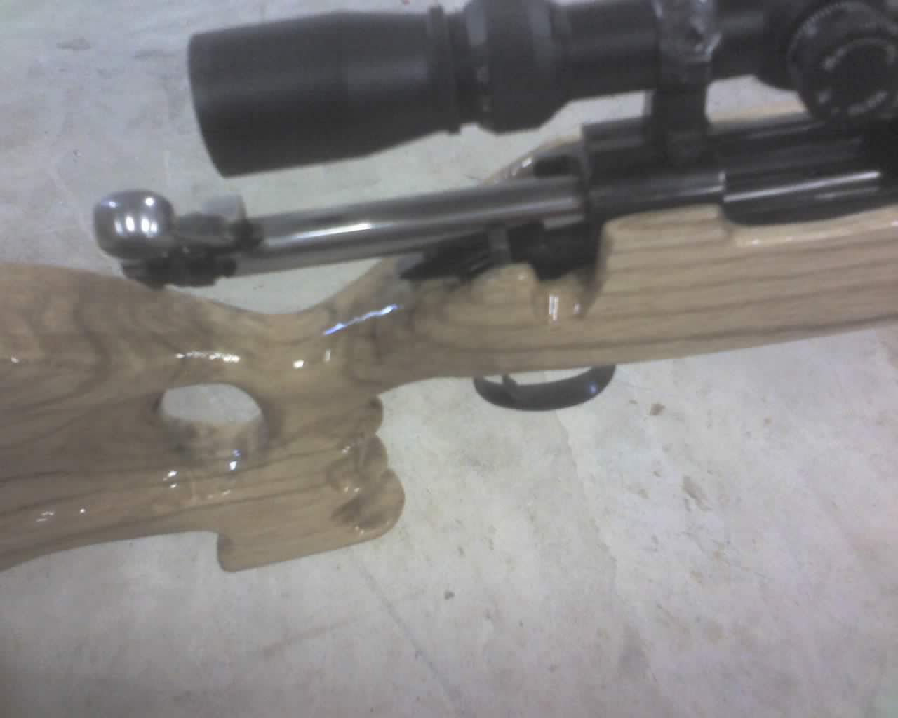

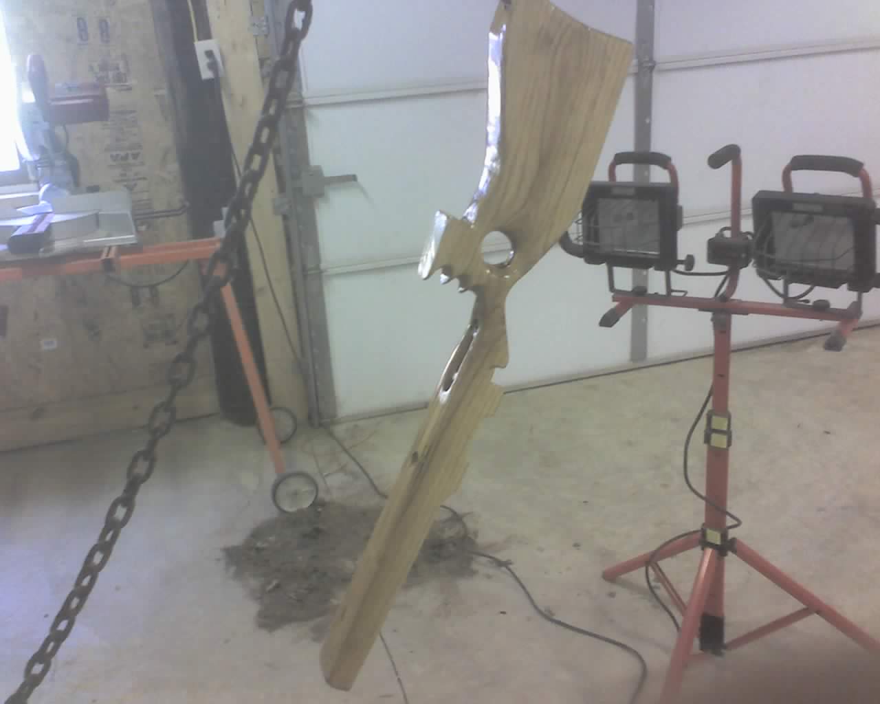

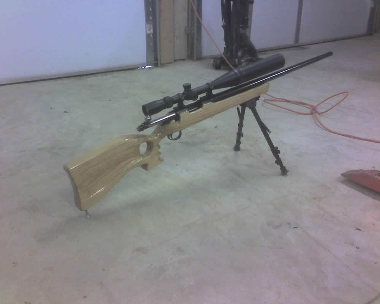

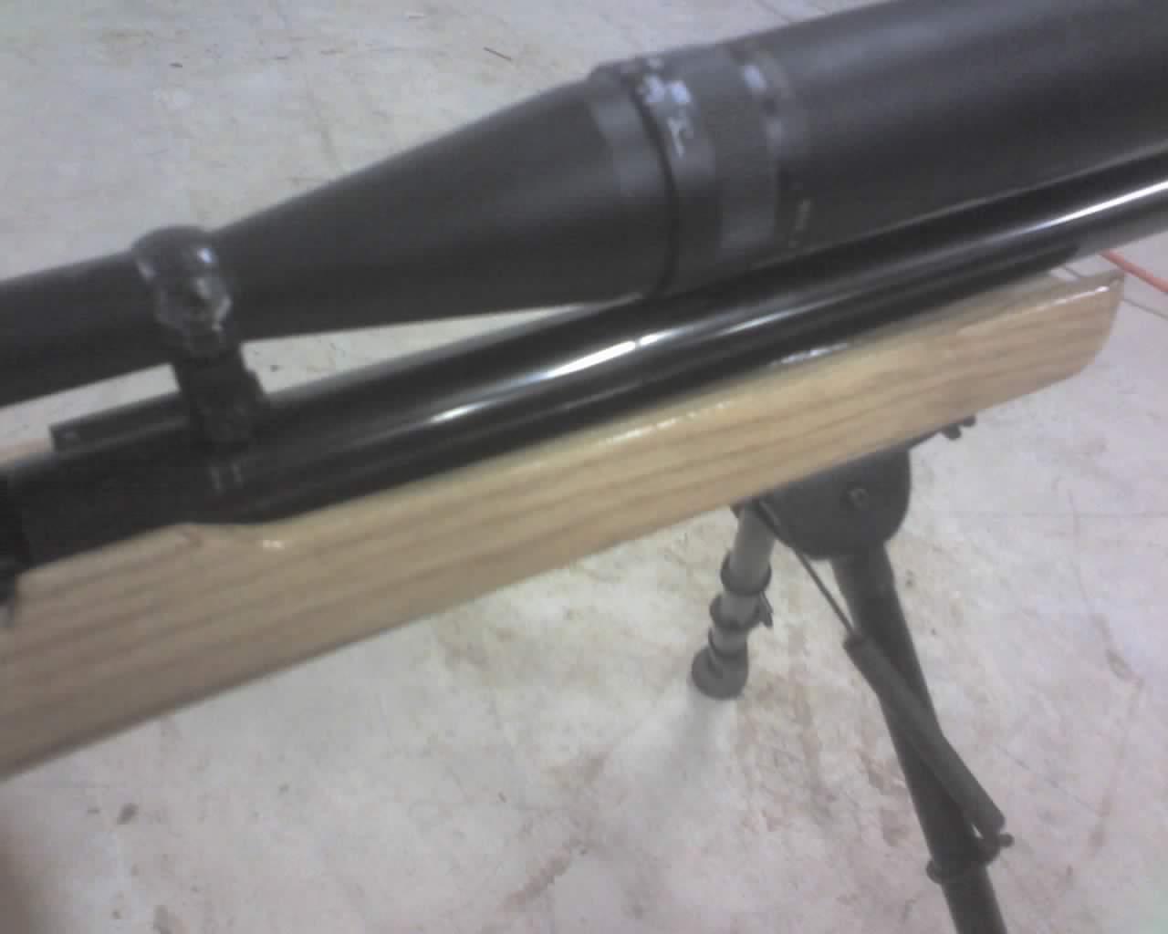

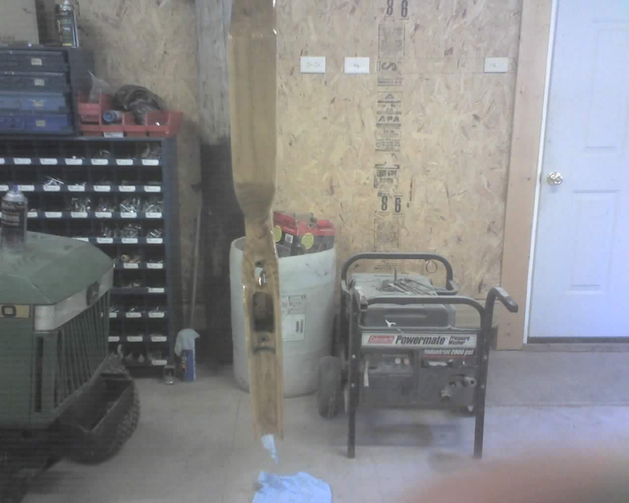

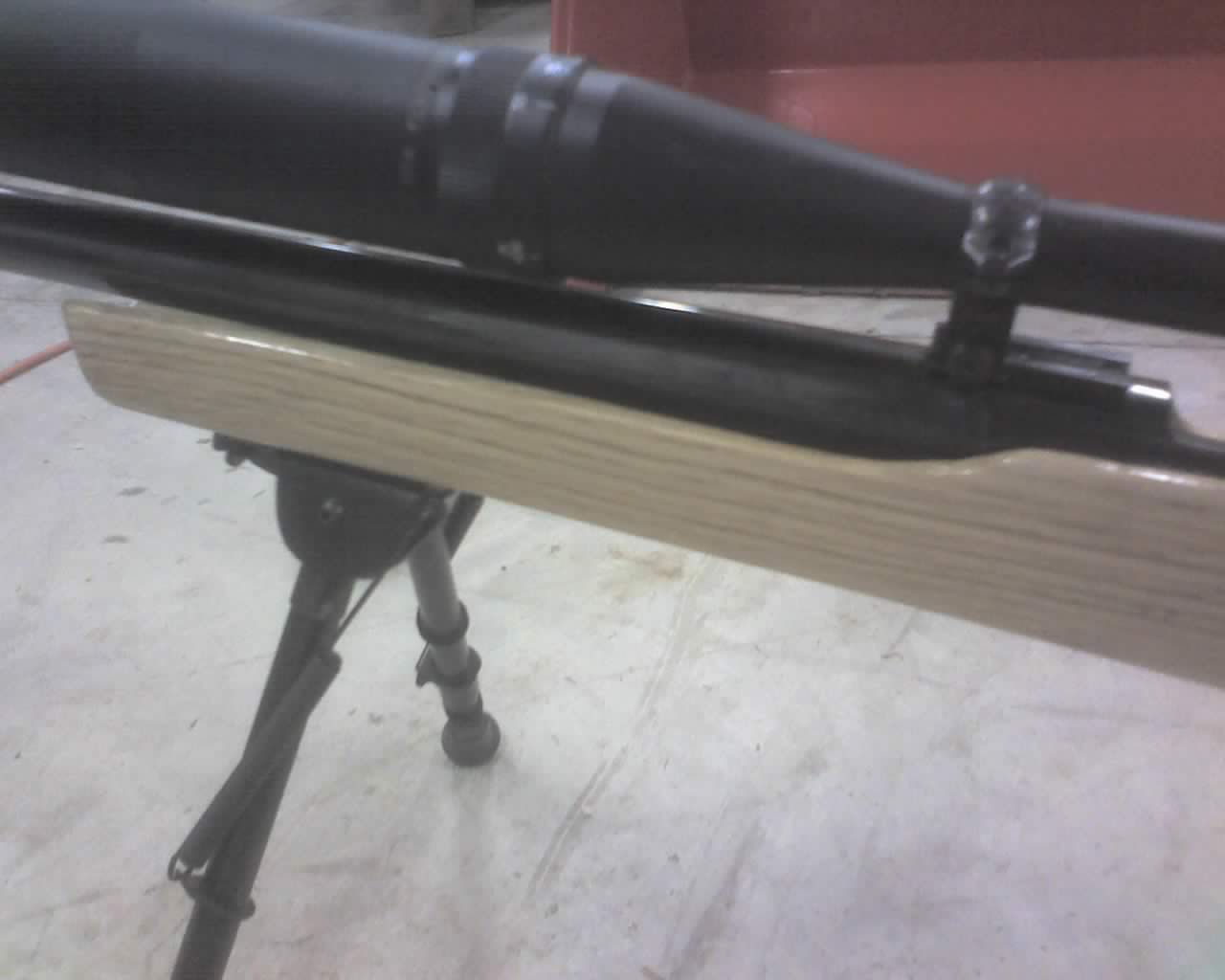

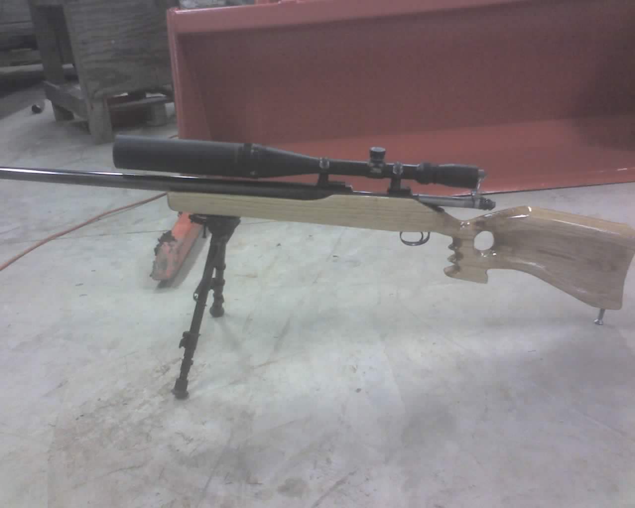

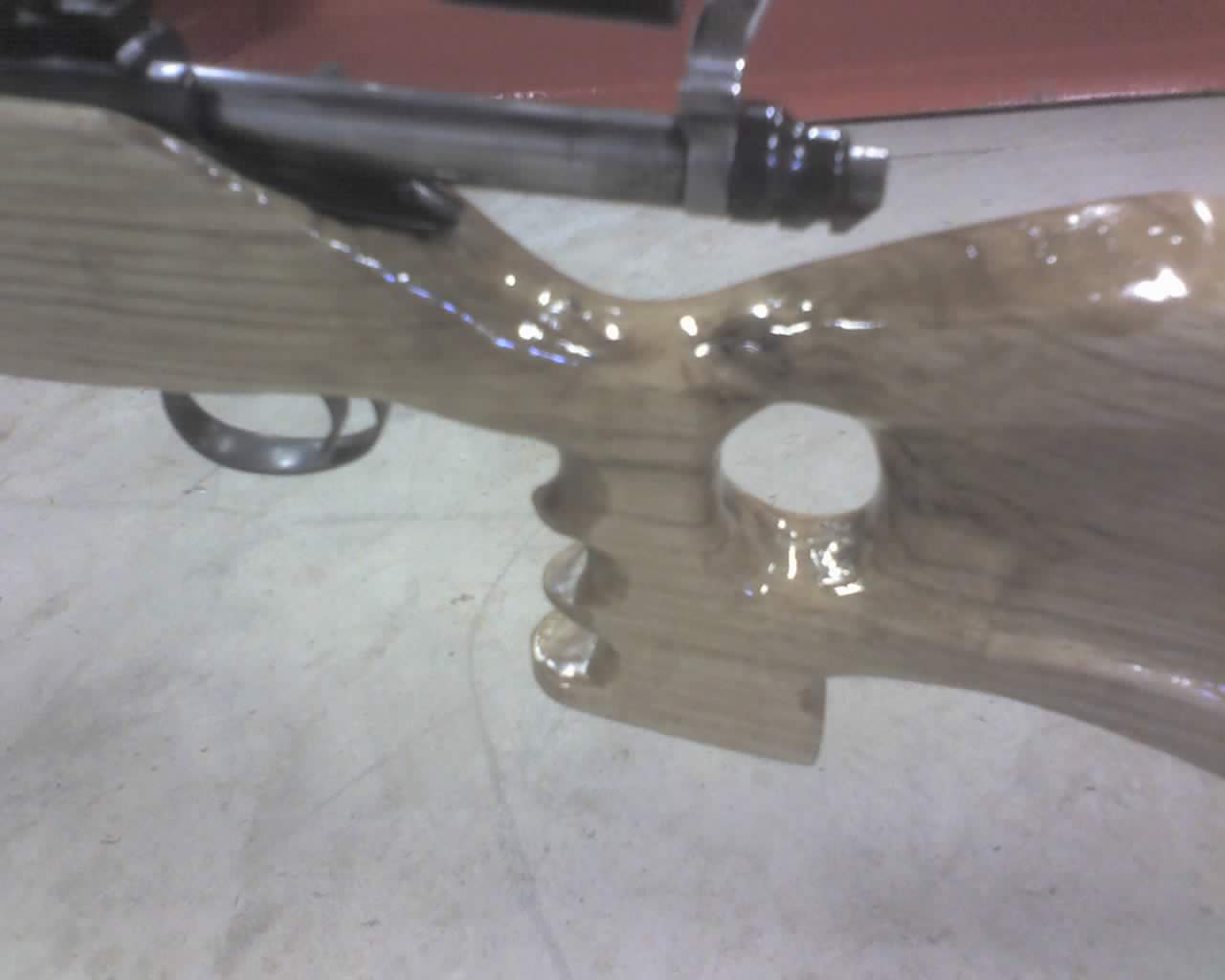

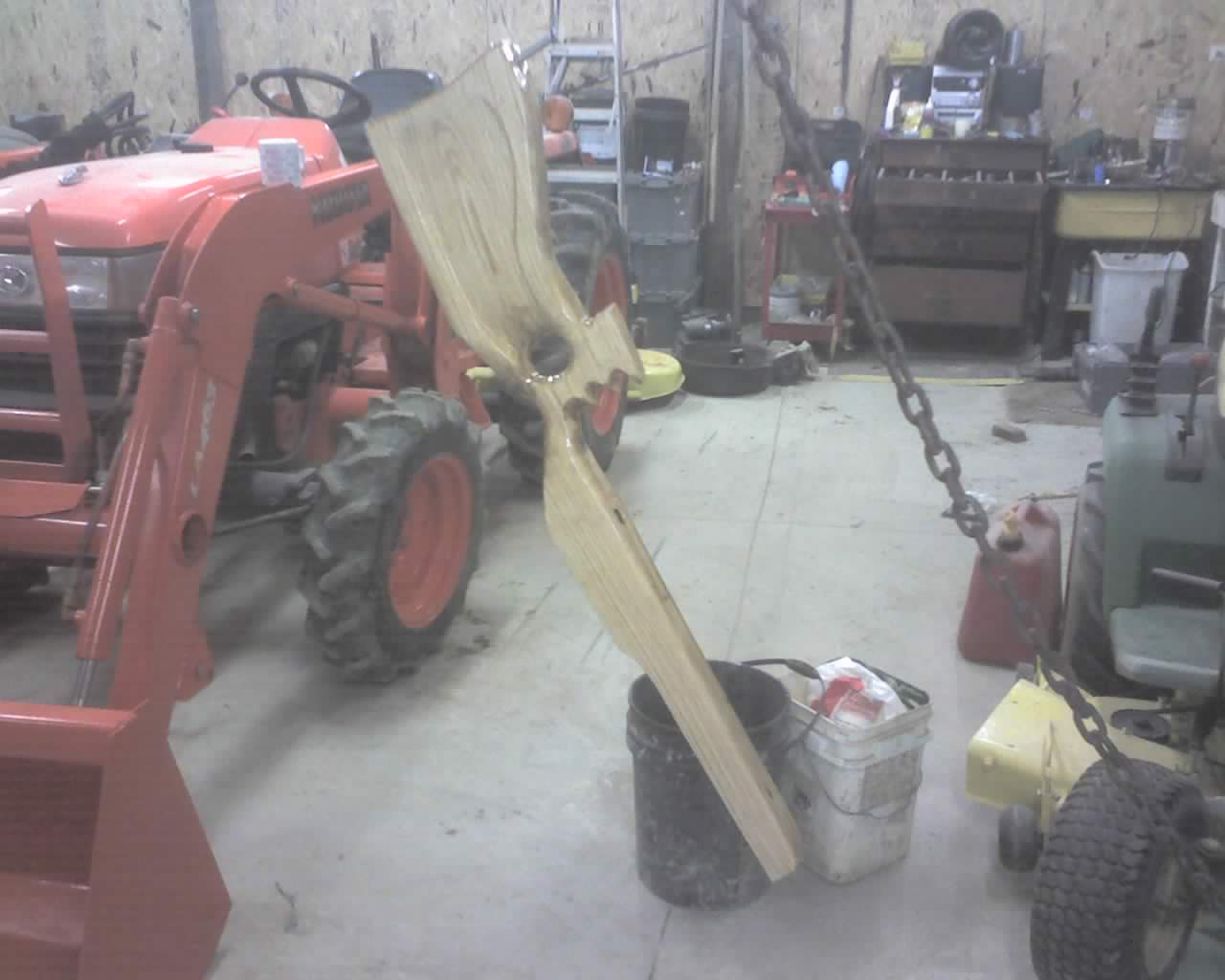

Just wanted to share some pic of the gunstock that I have been working on this week. Just finished the last coat of polyurethane last night and got her back together this morning.

That is very nice looking. What wood did you use?
I once made a few grips for my Colt Pocket Nine. I can't even imagine making a shoulder stock.:D
   / Hand Made Gunstock
I save a 3' long and about 10" diameter chunk of red oak from our weekend haul. I used the chainsaw, kinda like a chinsaw mill but only freehanded, to get a 3" by 8" board and went from there.
It's times like this I wish I had a decient mill in the shop.
Everything was done with basic tools that most people have.
Table saw(for squaring up the board after the chainsaw minor other things.)
Miter saw (rough notching here and there)
Die grinder with assortment of burrs, flap wheels, and sanding rolls)
Angle grinder with flap wheel
Drill (not just for the holes, used with the burrs when i was waiting on the little air compressor the catch back up. Also used a end mill bit in the drill for some of the work around the action)

Beautiful! I am thinking about making a stock for this SMLE barreled action I have somewhere in my shop. How did you did you adapt the stock to the action? Drill press and fostner bits + chisels?
No drill press. I used a hand drill with different sized bits to rough out the different areas of the trigger hole and the larger hole for the internal magazine. Then I used different burrs and a small 4-flute end mill chucked up in a hand drill. Yea it was time consuming and tedious(SP?). I tried a 2 flute mill of the same size but with a hand drill it was harder to control than the 4 flute.
