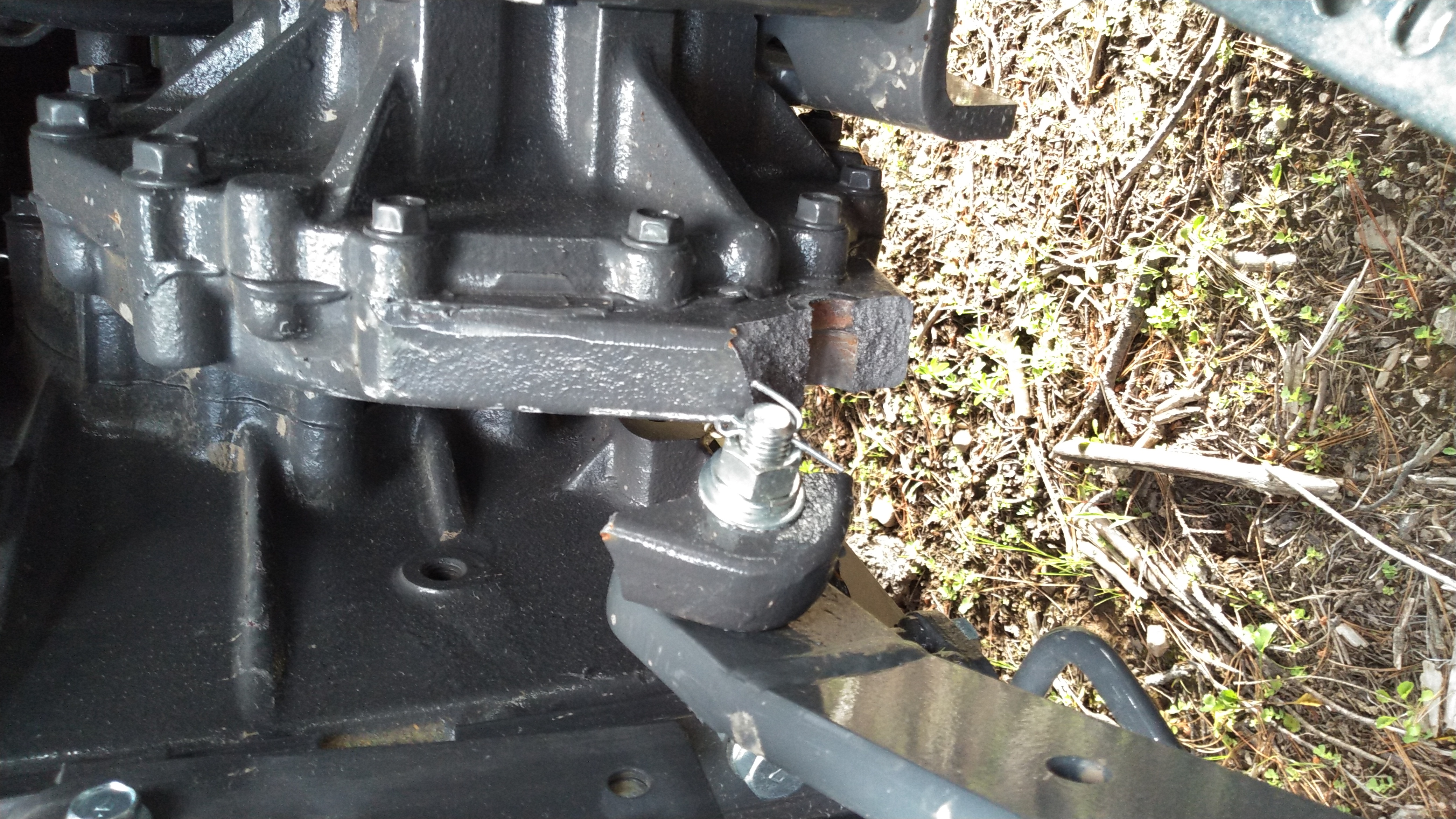

. . . and it's already broken . . . three point hitch attachment on the rear right side of the rear diff snapped off after ~300 yards in the forest pulling my box scraper in 2wd. Didn't even feel it break. Went to turn around, lifted the 3-Point and it was hanging funny. I am heart broken. My old Ford 2n has pulled that run > 100 times over the years and never broke a sweat. 7.8 hours on the tractor. :-(. Let's see how long it takes them to fix it.

Do you have any pictures?

Here is the broken bit. To add salt to the wound the tractor had 5.2 hours on it when we brought it home so I got less than 3hrs of use on it before this happened. I just can't wrap my head around why this part was the weak link that broke. Also makes me worried that even if it gets repaired properly this could just happen again. I feel like just returning it and asking for my money back. But I'm pretty sure lawyers would have to get involved for that.
And I have the 35hp version of this tractor, the least amount of power available. Are the guys with the 40hp-60hp version of this tractor breaking these too? I'm just bummed.

Welcome to TBN, so sorry to hear about the breakage of the new tractor, I hope the dealer and manufacturer take care of it for you.
I read a post here a week or two ago about a similar break, don't remember whether it was a MF or other brand. The only way for them to fix it right is a new housing.

Oh I'm sure it needs a new housing. There is simply no reason it should have broken. If it's that delicate it's worthless as a farm tractor. We'll see what happens now but to say my confidence in this tractor is broken would be a fair statement.
