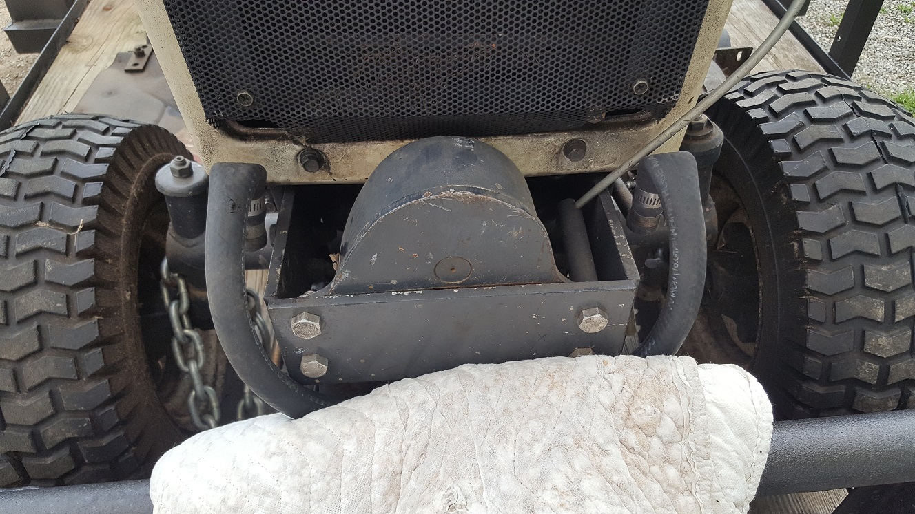

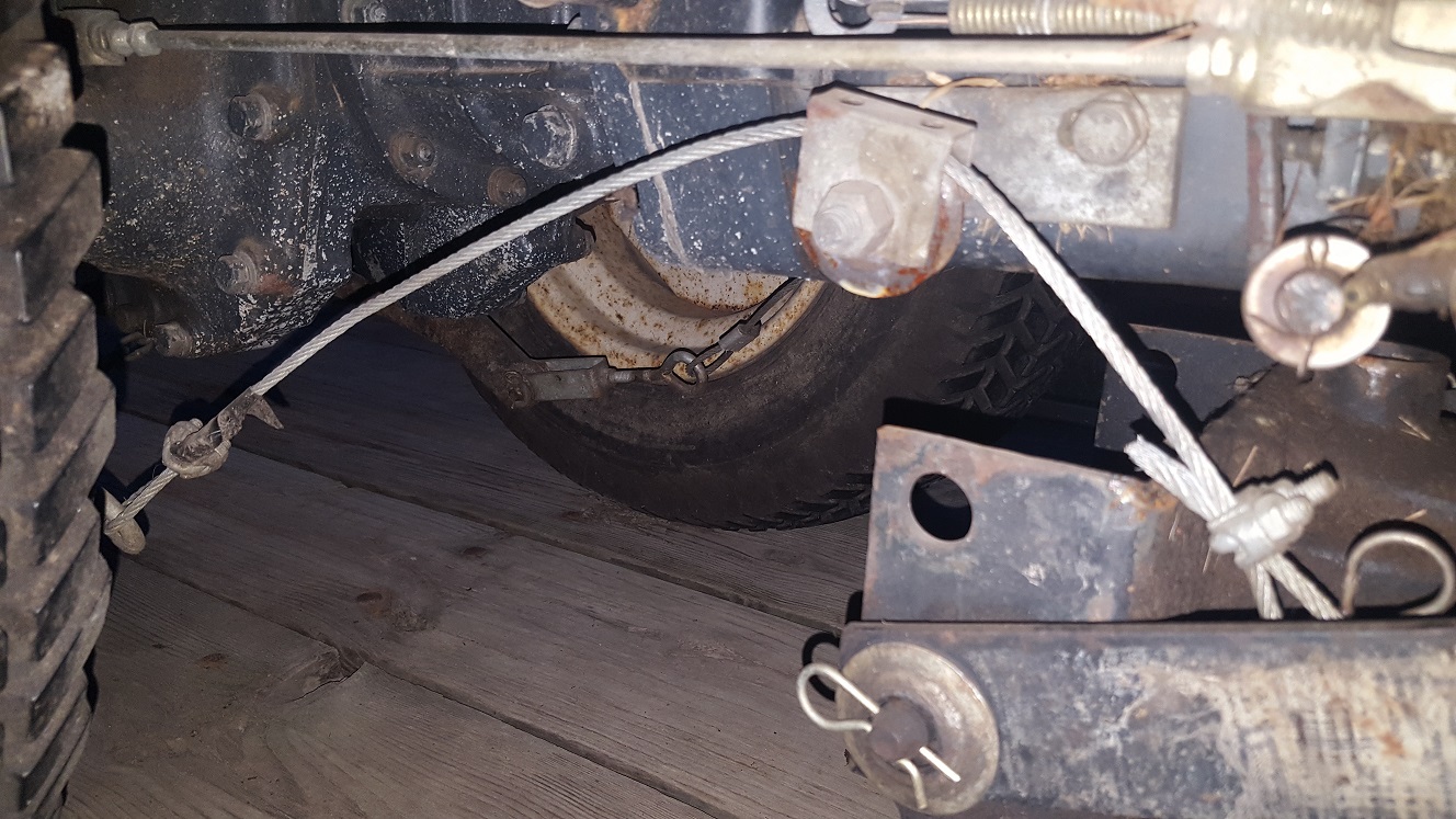

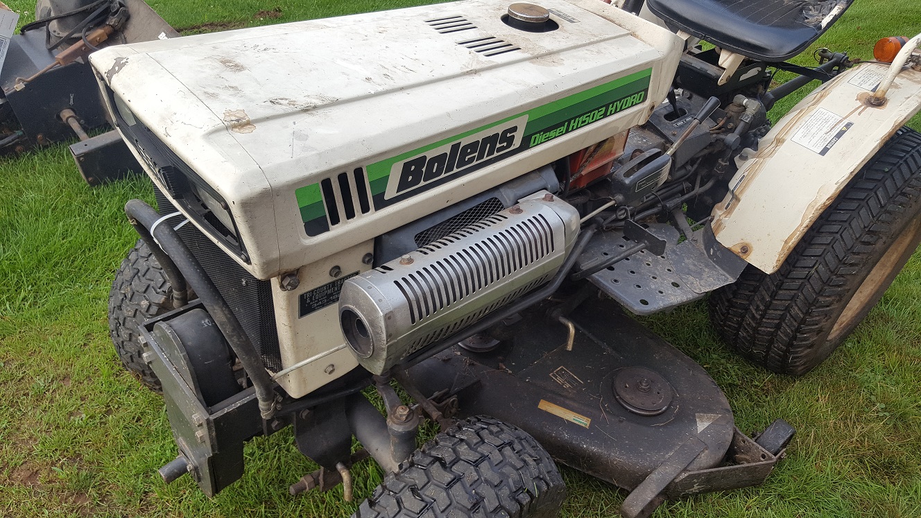

I just picked it up on Saturday. It came with a 17350 mower and 17377 snowblower; both of which I do not need. I have questions about the hose on the front and the cables on the each side that are attached to the 3 point. 20170722_075358.jpg20170725_194021.jpg20170725_204622.jpg20170725_204656.jpg
Please let know what is missing and what is needed. I plan to add a loader which I already have on another machine.

Hey James, My 1502 does not have that rubber hose on the front but those cables on the three point are for lifting the mower deck. If you ask me it is a terrible system, it works but those brackets that attach to the cables ruin your ground clearance and are a pain.

Thanks for the answers. The hose is because someone removed the hydro oil cooler. I added a replacement cooler. I removed the deck so l can sell it and install a loader.
