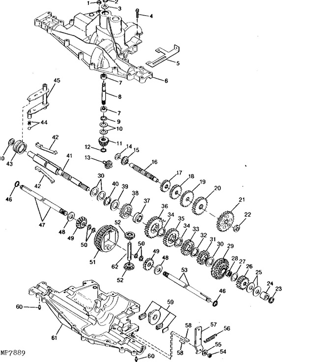

I'm thinking the brake pads are external to the transaxle...but don't have anything to go on other than the jdparts.com schematics that you can also look at. Shown in attachment.. and item # 59 is the kit for brake pads and disc I believe. Part # AM116883
Before opening the transaxle, maybe learn a lot more about what is in there.. ;)

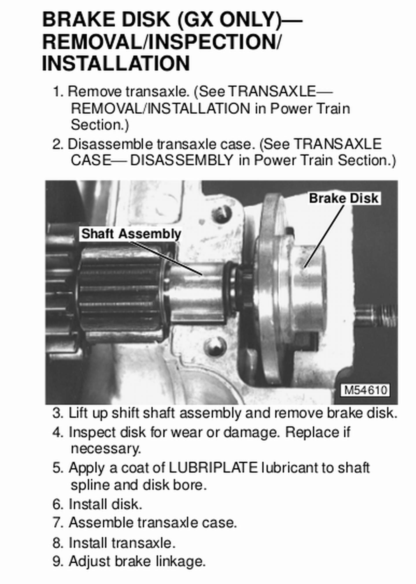

From the repair manual; to replace pads, remove disk ....
To remove disk, dismantle trans case ......
Sorry, I haven't managed to get the images the size I want but I'm sure you'll "get the picture." Anyway I'm delighted if you have conflicting information that lets me renew the brakes without splitting the case. Can you spell it out or refer me to the details somewhere?
(I'm using the John Deere Technical Manual TM1491 (July 99))
Thanks again for your interest & help.

This a rather straight forward simple transmission similar to transmissions used in other lawn/garden tractors.
You do not have to disassemble the transaxle to replace the brake pads. If, for some reason, you need to replace the brake disk, then yes, you have to split the case. I have replaced brake pads on similar transaxles and did not have to split the case.

I mean no disrespect but have you changed the brake pads specifically on a GX75, or only on similar transmissions from similar tractors? My reason for thinking I have to split the case is simple: the technical manual says so, as shown in the excerpt I attached. I'd love to discover that the manual is wrong about that. So far I've got no further than getting the trans out onto my bench and starting to clean the filth off it for inspection. Already have the big sheave removed. We'll see what we see next but I won't get back to it for a couple of days.

Does anyone here have real experience or specific information, on strictly the GX75 - as opposed to "similar" - trans axles and brakes? I see no way to get at the brake pads without splitting the case.
Several helpful folks have already offered opinions/advice but it's hard to reconcile their comments with details of the tranny I'm looking at on my bench. I can only conclude they haven't seen or worked on one that's the same.
/ GX75 RER refurbish questions #11
Well if the transaxle that you have is like the one in post #6, then yes, you will have to split the case to replace the brake pads. Take a close look, are the pads really worn out, or does the brake lever just need adjusting?
Thanks, Richard. The illustration in post #6 is of my tranny. Now that I have the crud off, it looks as if the outer brake pad is quite thick (surely can't be the original?) I'm not sure I can see the inner one; but the brakes do work when the lever's activated so apart from adjustment I'm leaving them alone. I'll leave the case unopened and assume it still has its lubricant (has been running fine without mechanical problems.)
But what a peculiar way to design a braking system !?! :rolleyes:
