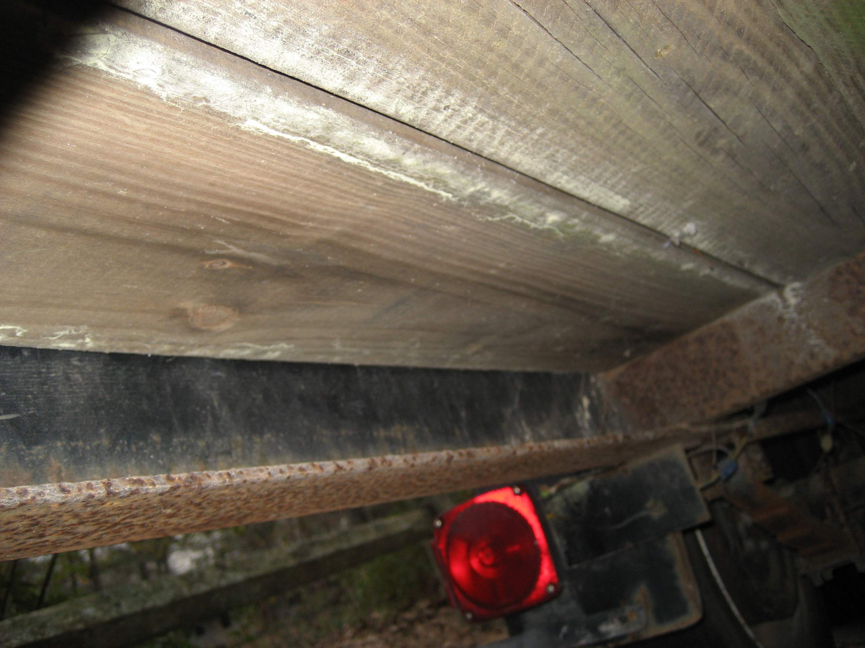

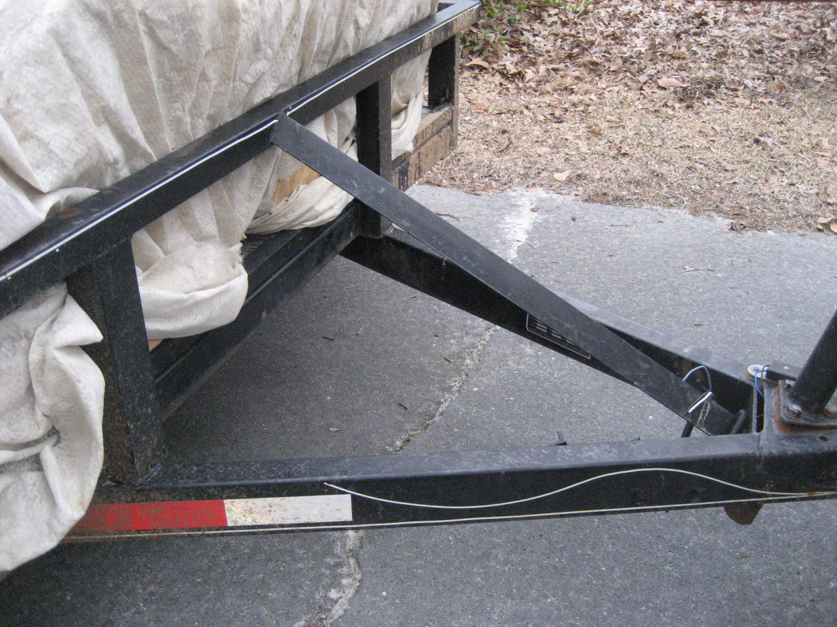

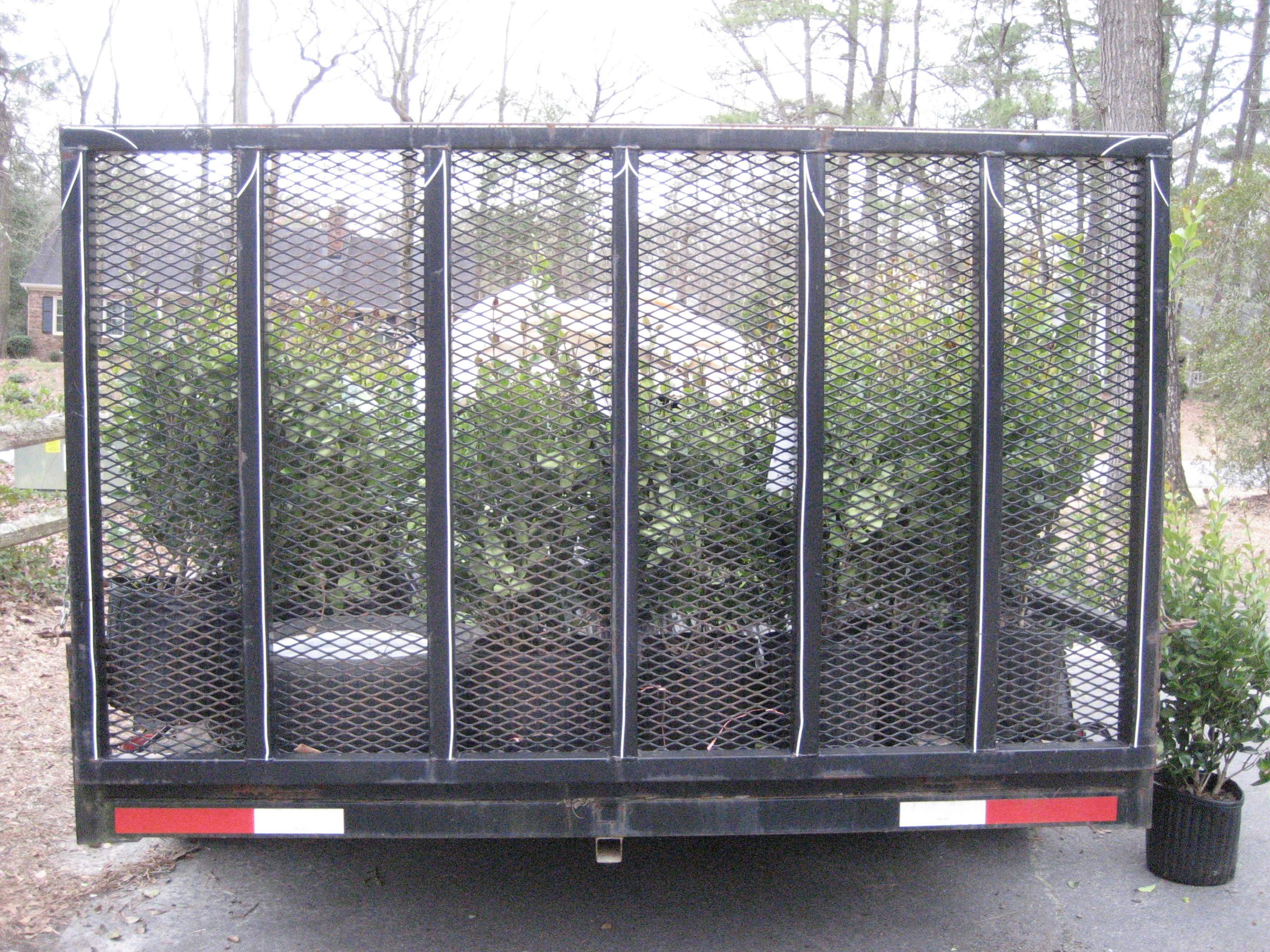

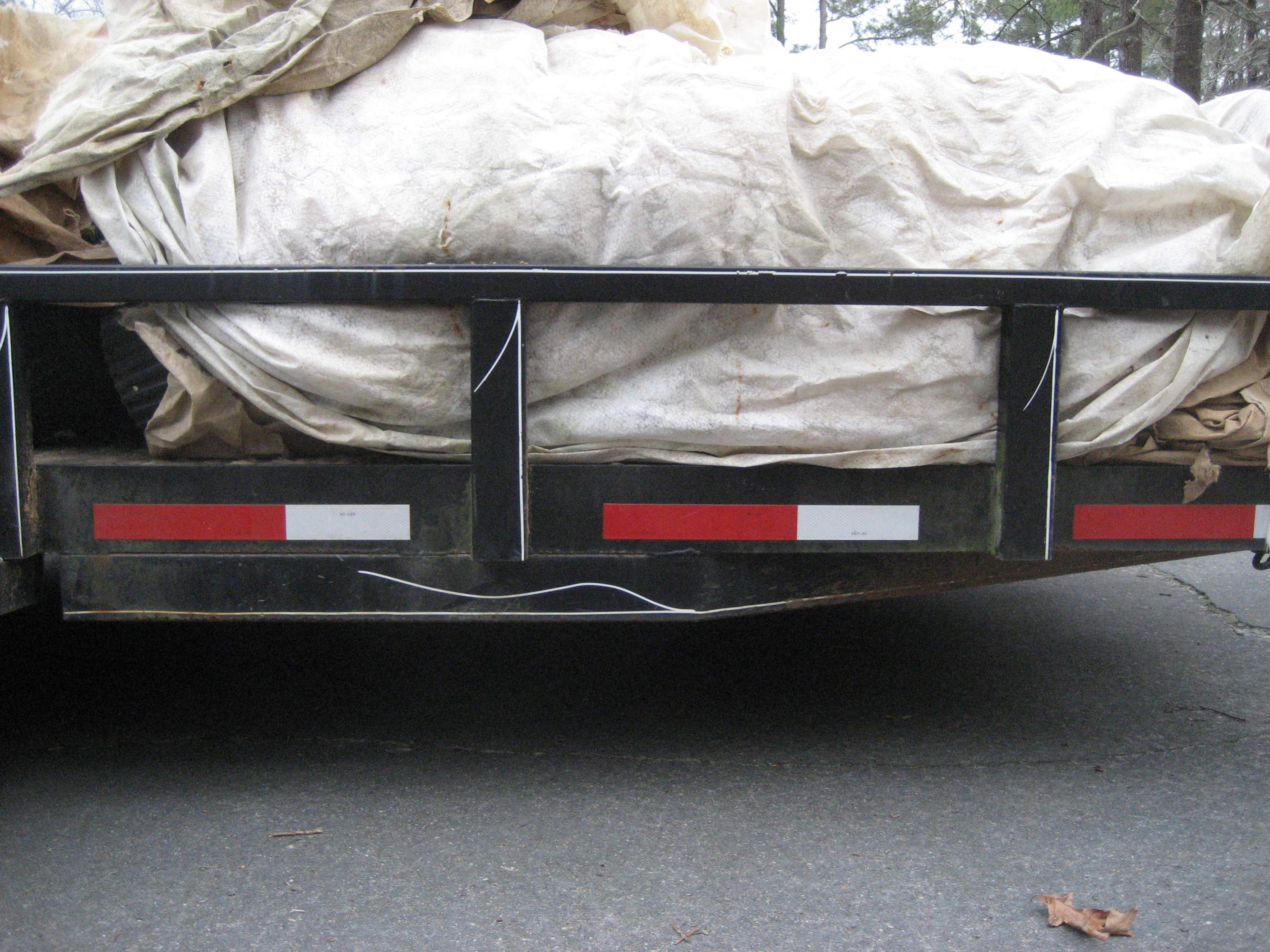

Here are a few pics.....maybe it will help...thanks.

   / GVWR and trailer label versus what is on the trailer #6
Chris knows his trailers, but to me looking at the frame tubes in front it's hard to tell but looks like it may not be 7K, especially if those tubes are thin walled. What does the coupler say? You will be limited by that. Also have to look at springs, if it was built as only 3500 pound trailer then the springs would (or may) only be rated as such. and also check tire rating. Seems a shame they would derate it in half, can't be that much a difference in registration fees.
I've got a similar situation where my tag says 9K but I have two 5K axles. At least you (and I) know the axles are not the weak link.
If you can't uprate it then it's gonna be cutting it close, putting 3K on a 3500# trailer, might just make it with 10-15% on the tongue, since you are able to deduct that from the payload, cause it's not on the axles.
JB.
   / GVWR and trailer label versus what is on the trailer #7
That looks like a 7,000# trailer to me. Check the tire ratings to make sure they are 1,750# or more each and you will be good to go.
Chris
