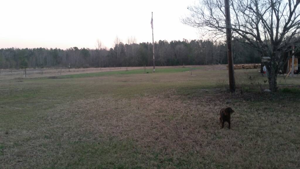

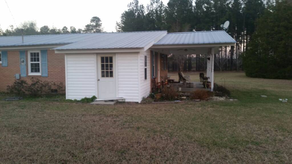

Here's a shot of the roof line where my issues are, most of the house is brick and raised so I don't have the flooding issues elsewhere but PPP resulted in this being below grade.
This is a shot standing at that corner looking back out into the yard. Plenty of opportunity for a french drain but no where to just run it out on top without being in the way.

Gutters and french drains are a maintenance nightmare. Consider using your tractor to form a swale for drainage that will handle water far superior to 10 french drains.
Gutters: I have gutters and I wouldn't put gutters on another house if I built a new house every year and lived to be 500. My money would go towards concrete properly sloped from the structure where leaves, pine needles and leaflet stems can be taken care of with a blower.
