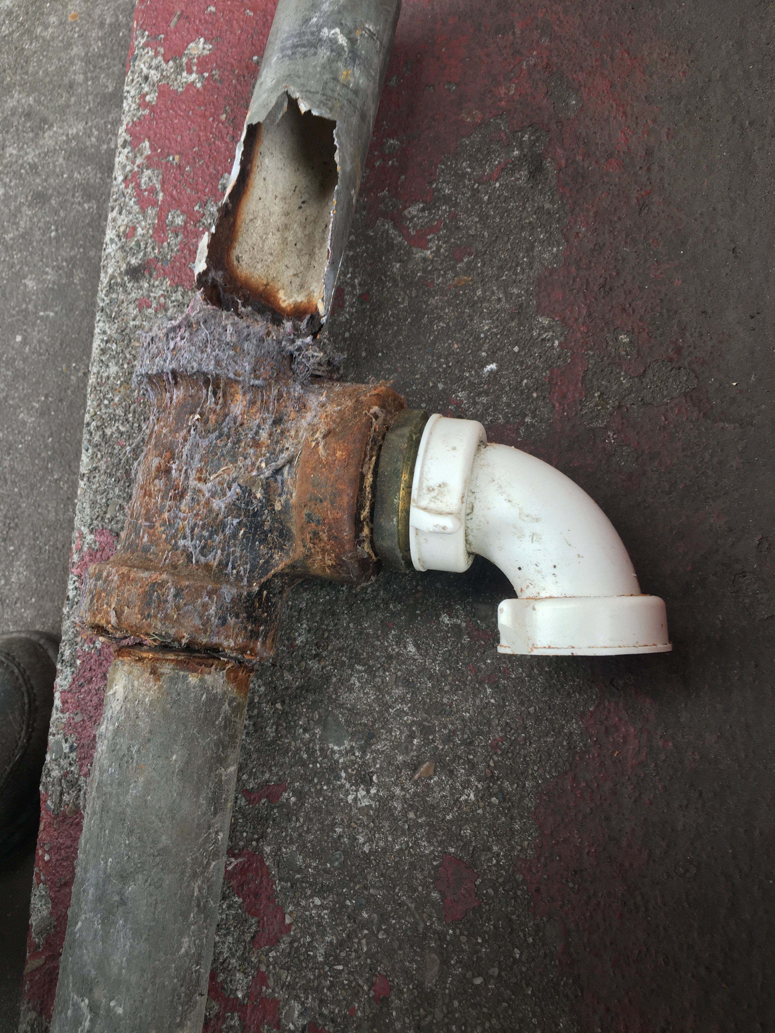

Yesterday tenant called saying strange noise from laundry sink when doing laundry… the washer drains to the sink.
Water was everywhere when she returned from shopping while washing a load.
I asked about the lint trap on the washer discharge and she said took that off years ago…
What I found was galvanized scale and packed lint obstructing rotting out the pipe.
The laundry sink is original to the 1920 home so a mix of Galvanized pipe in the wall and Cast Iron under the floor.
Cut the wall open and the galvanized crumbled from the Sawzall.
105 years so I can’t complain.
