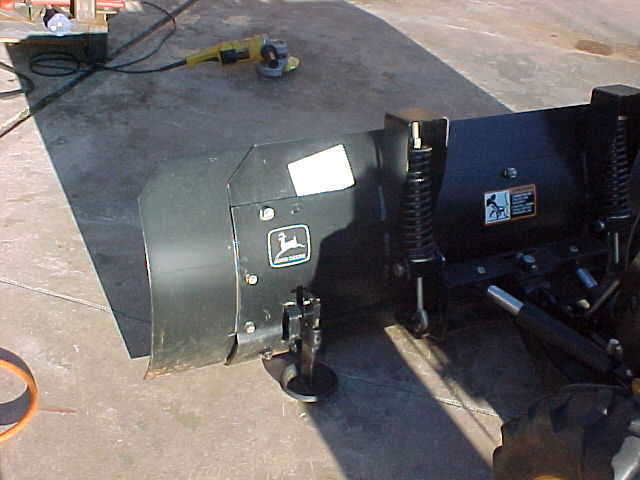

Bowl bottom type Skid Shoes came with my Front Blade. They leave scrape marks on the asphalt road that serves our neighborhood. In all there is about a mile of road I want to clear when snow finally reaches Oklahoma.
My hope was that guide wheels would help keep the cutting edge off the road and not damage the blacktop (and lessen wear on the cutting edge, too). Here's a pic of the guide wheels mounted on the blade.

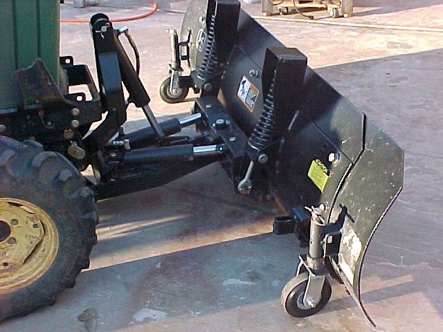

With snow removal in mind, I purchased the JD wing and top extension kit. They add a little length and height to the basic blade, for moving light material, like snow. This pic shows the extension kit installed and the original skid shoe in place.

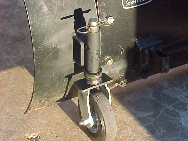

I bought the smallest rubber wheel I could find that had a grease fitting for lubing the axle. The mounting plate on the wheel was trimmed some and a Cat 2 pin was welded on top, tilted back at an angle so the wheel would trail properly (I hope).
Washers are stacked between the bushings and the wheel to adjust how close the blade is to the ground. This pic shows a closer view of one of the guide wheels installed with three washers stacked as spacers. I'm using thick washers, about a quarter inch thick.

Overall, this project came out about the way I had hoped, but I don't know if it will actually work well in the snow or if the little rubber wheels will stand up to the abuse they'll get. I've got my fingers crossed.
