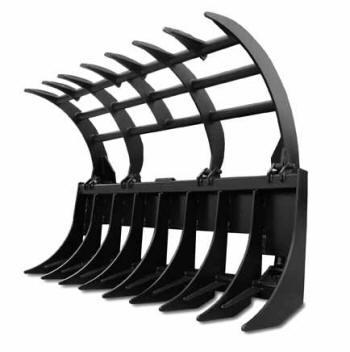

Guess what this threads about? Grapples!
I know there are alot of grapple threads, but most of what is talked about is about how the 48" wide can do the work of the wider ones, and in most cases is better because it focuses the pressure to a smaller area, for uprooting trees and such.
My question is, how narrow is TO narrow?
I have 50 acres of woods, and am working on clearing a long drive, and am starting off with a small area for a camp/eventual home site. I know there is other equipment better suited to this task, but that is not an option. I don't have the money, but I do have a nice 40hp tractor with a loader. And I enjoy hauling it over there and working on my days off, I am in no hurry, and so far I have made great progress with just the bucket. But I need me a grapple.
The two I am looking at is the Markham light duty grapple 48", that many on here have had good luck with.
The other is the Mini gator Extreme, which is 30" wide, and is much more robust/stouter design.
They cost the same, and the weight should be about the same.
I am sure the Gator will be better at uprooting the trees, which is what I will be using it the most for. But at 30" if I have to move brush piles and such, would it be able to get a good enough bite? What about moving old bales of hay? I am thinking it would be fine for moving trees with trunks, but I am not sure about pulling out brush and similar things.
What do you more experianced guys think?

Mini Gator vs 48 inch grapple for dealing mostly with trees...good question.
I don't have any experience with the mini gator but I know what it is and have seen the photos. I do have a lot of experience using a 48 inch grapple on essentially the same tractor you are using (mine is the Kioti version with the KL401 loader). With brush the grapple wins though the mini gator could certainly manage brush. The issue with trees is whether or not the mini gator really has a significant advantage. I take out trees quite frequently though my major battle is with brush. When I need to take out a tree I use the grapple elevated to about 9 feet or so to push on the tree until I have exposed some roots then I back off and use the grapple to get under the roots. I can do that with the 48 inch root grapple without much difficulty so I don't know how much more efficient a mini gator would be. I think the biggest factor is the weight of the tractor (for pushing) and the strength of the loader (for uprooting). I would think the shape and size of the grapple would be less of an issue especially when comparing a 30 inch to a 48 inch grapple. Both would have a big advantage over a six foot grapple.
The mini gator is based on the trapazoidal shaped stump bucket and those buckets seem to get mixed reviews. They do allow you to focus a lot of power in a small area but they are pretty much limited to that one task.
I don't think there is a clear answer to your question. If I had to do it again I would definitely go with the grapple as it is far more versatile but I cannot say that it would do a better job of the task you outline in your original post.

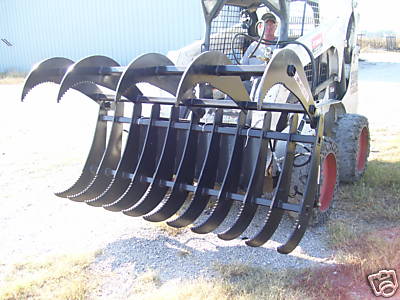

Looking at the photos (and skimpy info) on the Markham site, I can't really tell how the Gator/Mini-gatror is different from the standard Markham root grapple. Can someone enlighten me?
From all the reading I've done, I'm probably going to order a 66" standard duty Markham unit with extra spacers. This is primarily for a JD 325 skid steer but I might also use it on my Kubota M5040 tractor. I know some have suggested that narrower is better, but I do want to be able to clear a path for the skid which is 72" wide (standard bucket is 78").
