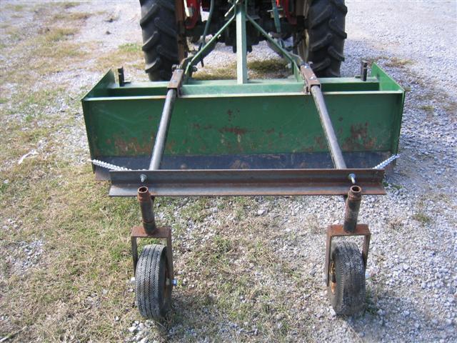

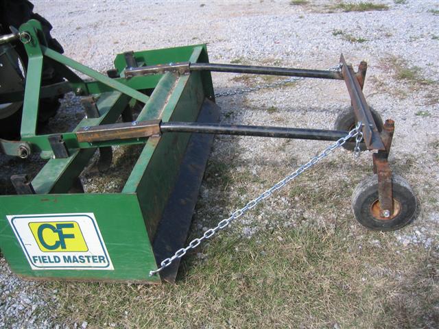

Yet another set of guage wheels for a boxblade. I raided the scrap pile to put this together. The bolts, chain and other hardware came to about $20. Not as pretty as some of the others I've seen posted here, but it works.

That's a nice set up for box blade gauge wheels. Gives a long wheel base for better levelling. :D

Question: are the wheels tracking well for you? The first set of casters I made did not track because I didn't cut the sides for a ~30° angle.

Nice job! I think if you were to put turn buckles on those chains you may be able to easily adjust the height of each wheel a bit by tensioning the chain.

Question, would you all prefer the wheels to be inside the cutting width of the box or outside. It would seem to me that it would be better on the outside so that what you are cutting or spreading would not also effect the wheeel height. For example, if you were using wheels in order to limit your cutting to 1 inch. Wheels inside would then be one inch down after you cut. this would thenhaev the affect of cutting down 1 inch more than one inch more. I am slow, or does what I am saying making any sense. :confused:

I pretty much threw this together with odds and ends that I had, and as such made everything fit the material at hand. If I were to build the thing from new material, I would have put more angle on the sides of the casters. While they "track", they seem to be a little slow in centering.

I thought about that as well, but after hooking everything up, I found that I could easily adjust the height of the blade up or down by adjusting the turnbuckle on the box blade. Granted, in doing so it adjusted the angle of the blade some, but since the wheels are only used in the finish stage, that didn't really matter.

My thinking is that having the wheels on the outside would cause the blade to simply duplicate the existig structure. My purpose was not so much to maintain a specified depth of cut, but to even out the ripples that occur with a box blade everytime you go over a bump. Kind of like a plane.
