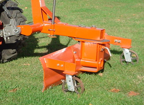

I have read several posts about building some guage wheels and have one question. Some people have used essentially heavy duty casters from Harbor Freight or TSC for the wheels. My question is how have these held up? With the wheels getting so much dust do the swivel mechanisms hold up? Even the ones that you can grease I would think would just get gunked up with dirt. I would think something like what is on my mower would work beter but I am not sure how easy it would be to find the correct parts. On my mower they basically have a plate mounted off center of the wheel with a rod sticking up that goes into a piece of pipe. There are washers on either end and a cotter key at the top to hold it together. There is a grease nipple so you can fill the whole thing with grease. This seems like a better setup since it has no ball bearings and would stay relatively clean. Would you be able to find a rod and pipe that would work well enough do make your own?
   / guage wheels #2
Eric,
Your assumption is correct. Open bearings, grease and dust are not a good combination. I deal with it all the time. My answer is timely grease gun applications.
I am one member that uses the (large) castor system. It was much cheaper and in my case I use them on my RB for snow removal where dust is at a minimum. On the other hand, cinders and salt can raise the devil with open bearings too. again.......GREASE.
Agri Supply has some pretty good looking gauge wheels and supports in their inventory. You might check there.
I think you will like gauge wheels on your blades and rakes no matter what system you end up with. Check out Homebrew's setup. A high end setup in MHO.
Big Dad

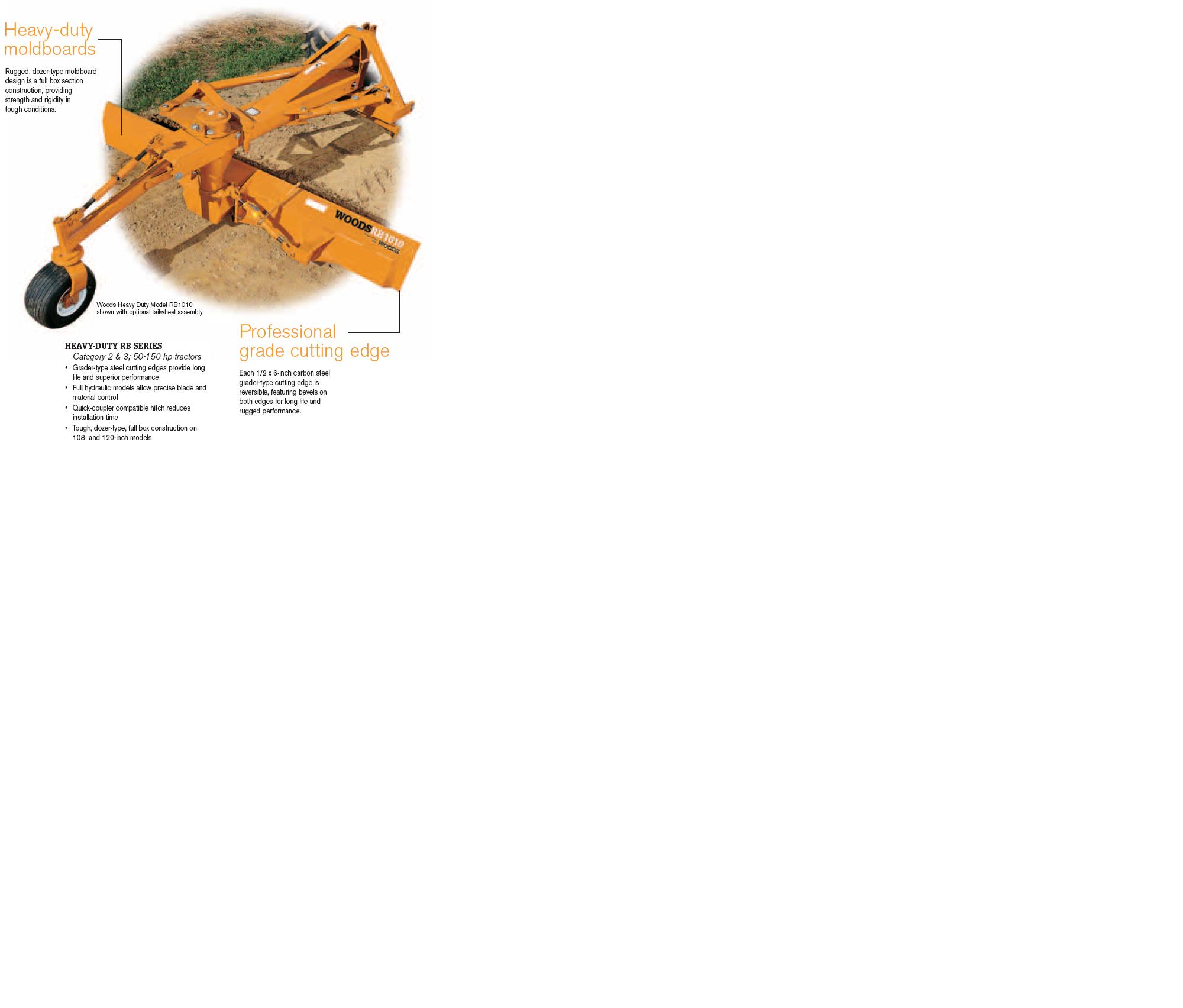

Here's a pic of the Woods tailwheel which looks like the best design I've seen.
No offense to anyone!

That looks like a nice, clean gauge wheel set-up that Homebrew has.
Does anyone know if the gauge wheels in that set-up have any adjustment for depth?
Thanks,
Dave
