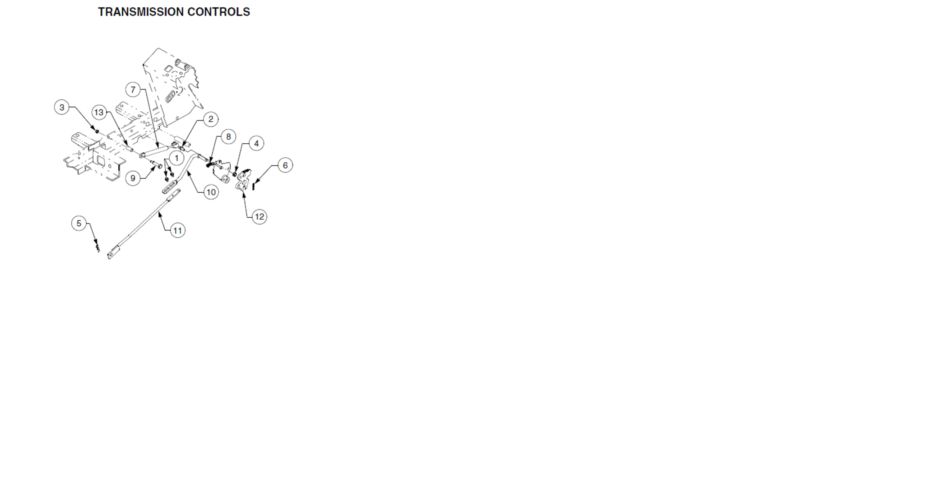

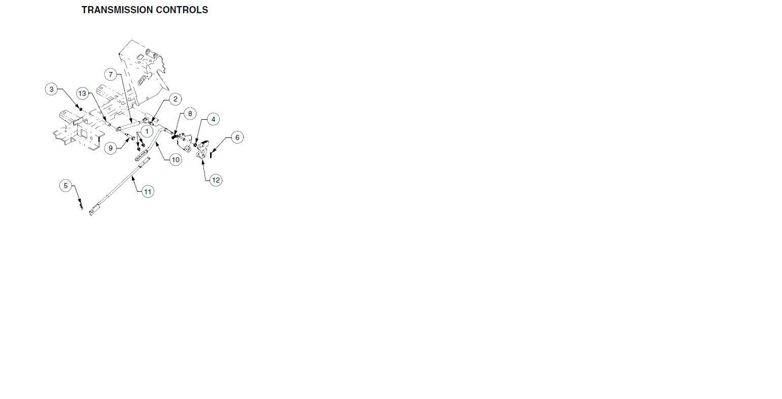

Thanks for the suggestions. I've looked under and cleaned it up a bit. I think it improved a little but not enough. I am looking at the "cylinder damper" (looks like a tiny storm-door hydraulic closer.) Is it possible this could be failing? It seems like this is what is supposed to pull the forward pedal back after I let off the gas. Take a look at #7 in the parts diagram I uploaded. trans.pngThanks.
   / GT2550 forward pedal sticking / unable to apply brake pedal
I went ahead and ordered the cylinder damper part. I'm going to change my trans oil and filter as well. Will let everyone know if that fixes the problem.
