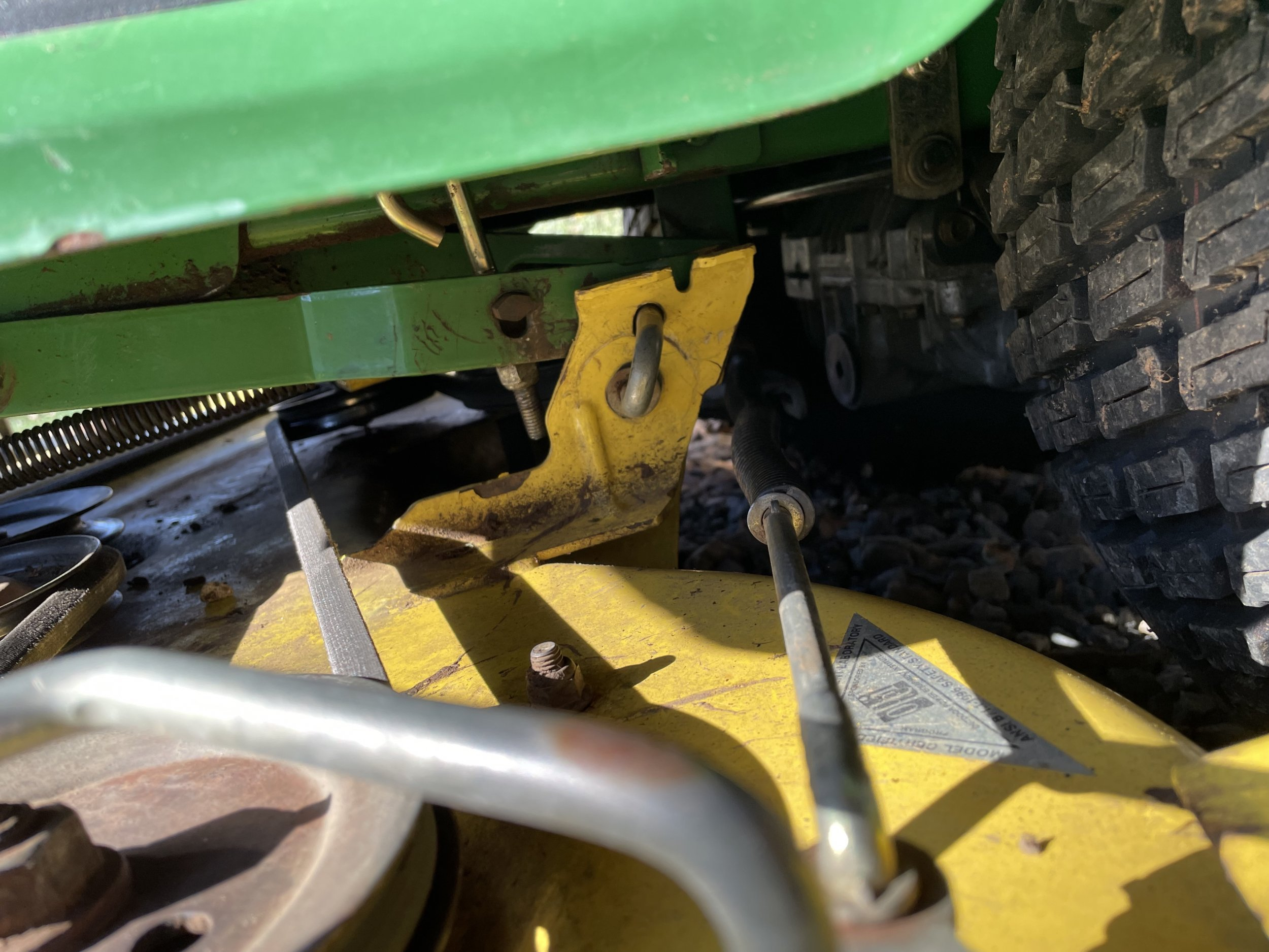

I am hoping someone with this model would be so kind as to take a photo of the link arms as they are attached to the deck. My deck has a habit of coming off, and I can't see where anything is bent, etc. The arms are not installed quite like the parts diagram depicts, but I can't seem to get them attached to the deck any other way... at any rate a picture is worth 1,000 words as they say. Thanks.

Post up a pic of what your attachment hookup looks like. That could help someone spot a problem to solve your issue.
   / GT235 Mower Deck Install / Removal
It appears the deck is connected properly, from what I can tell.
   / GT235 Mower Deck Install / Removal #5
When you say the deck falls off, does the entire deck come off, just the front, just the back end, just the right side, just the left side......?
   / GT235 Mower Deck Install / Removal #6
A couple of things to look at. If the yellow brackets on the deck are splayed apart you can loose the deck. A quick squeeze together to remove the unnecessary slop is all it takes. If the holes in the rear draft arms (green arm) are badly worn that could contribute as well. I've had a couple of customers over the years remove the J hooks and put a pin with a spring clip or simply bolt the arms to the bracket when things get worn. From the pic, it looks good.
