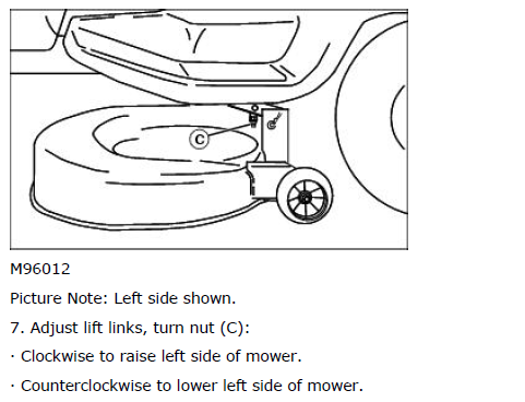

I have a service do lime, fertilizer, aerating, etc. They tend to tell me I need to mow the lawn at 4" to avoid turf damage. My 48" deck is set @ 3.5 on the dial, and I mow with the deck in the transport position. I'm getting 3.25 or so inches of height. Can I just crank on the lift rod bolts and get more height, or is this unwise?

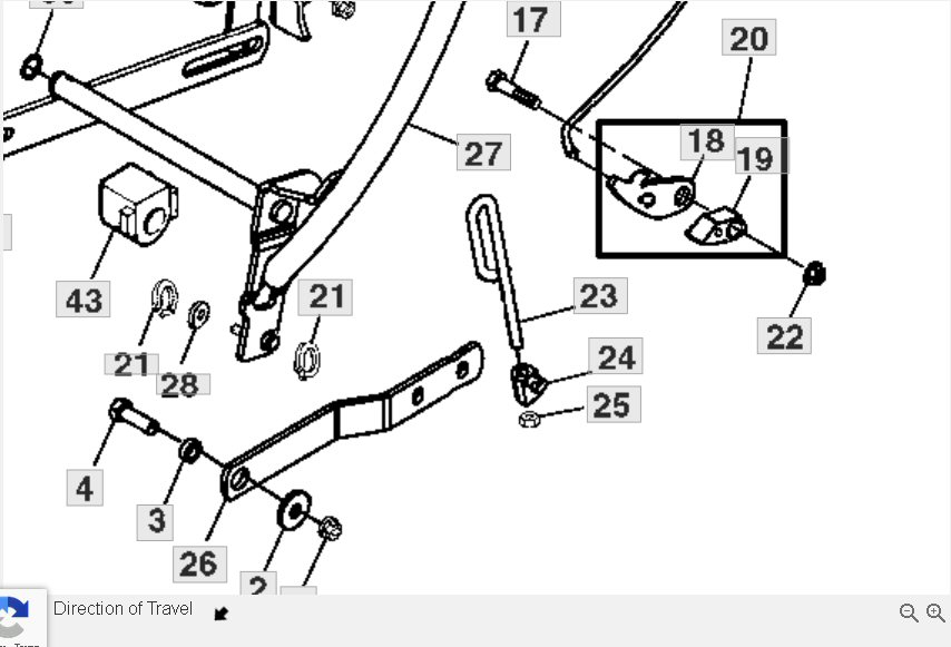

You should be able to adjust the lift links, #23 in the picture, enough to get another 1/2" to 3/4" in height. Just make sure nothing is hitting or rubbing.

You can get close to 4" in the transport position. Two nuts raise each side.
   / GT235 Deck Height - How High Can It REALLY Go ? #6
Crank it all the way up, it doesn't hurt anything (just look that everything still clears).
