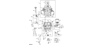

The dipstick does not appear to have an o-ring. The parts diagram does not point to the presence of an oil ring, either.
   / GT235 (Briggs): White Smoke // PTO engagement causes engine to stall #9
It is on the tube by the threads, item #32 in the diagram,
the part number is LG691870
Probably not your issue, but it fixed mine having a big puff of smoke when I start it. I didn't actually replace that o-ring though, I had one that was the perfect size to fit in the bottom of the dipstick cap and stuck it there instead. So technically I have two on mine now.
