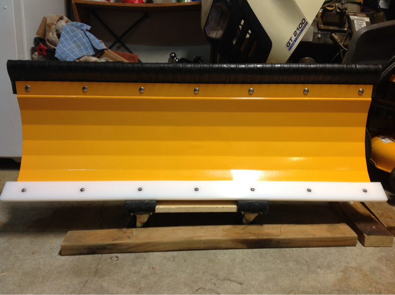

So I upgraded several things on my brand new snow blade last year and posted the details and photos on the site last year. One of the improvements I made was upgrading to a thicker wear bar, which worked ok but wore down too quickly. I just used some 3/8" bar stock that was obviously too soft for this application so I started researching what metal composition I should go with and noticed a few guys using polyethylene. I did some research on different types of poly made and found UHMW (Ultra High Molecular Weight) to be commonly used for plow edges by the pickup plow manufacturers. I contacted a plastics company I had dealt with in the past & they happened to have some scrap pieces so I picked up a 48" long 3" high 1/2" thick piece. Tonight I used my old wear bar as a template and drilled the holes and mounted the UHMW to the plow and waxed the blade (see attached photos). I left the wear bar long on the ends for plowing along curbs. Now I am ready to test it out as we have 4" of snow forecast for Sunday!
I'll let ya know how it works.
John

.... So,I've had the UHMW poly edge on my blade for a month but here in Nebraska we have been bypassed by all the snow this year. I have been reading on the forum about everyone getting seat time working (playing) in the snow, I am still holding out hope. We only got 2" when they forecast 4-6 early December and an inch last week, that's it. But I did get to test out the poly edge and I can say it has worked even better than expected, it is super quiet and doesn't catch & trip nearly as often and has worn less than the metal bar I had on last year. I was skeptical about if it would scrape down to the concrete all the way but it sure does, even when vehicles have driven over the snow and compacted it. I doubt I will ever go back to metal except for summer use moving dirt, gravel etc, I would recommend UHMW to anyone!

As far as UHMW goes I am not sure of the differences, I have the white stuff on my blade but I have seen it in black like you have and also red and yellow. I guess I would be interested to know if it makes a difference & what color would have the most wear resistance. All I know that the white UHMW I have on this year has worn less than the 3/8" thick metal I had last year with comparable use time on it. Isn't that stuff nice to work with, it cuts and drills like balsa wood! I had to keep oil on the bit when I drilled the metal wear bar last year. I know one thing though, with the prices some of these companies get for wear bars in various materials, I will continue to make my own!
