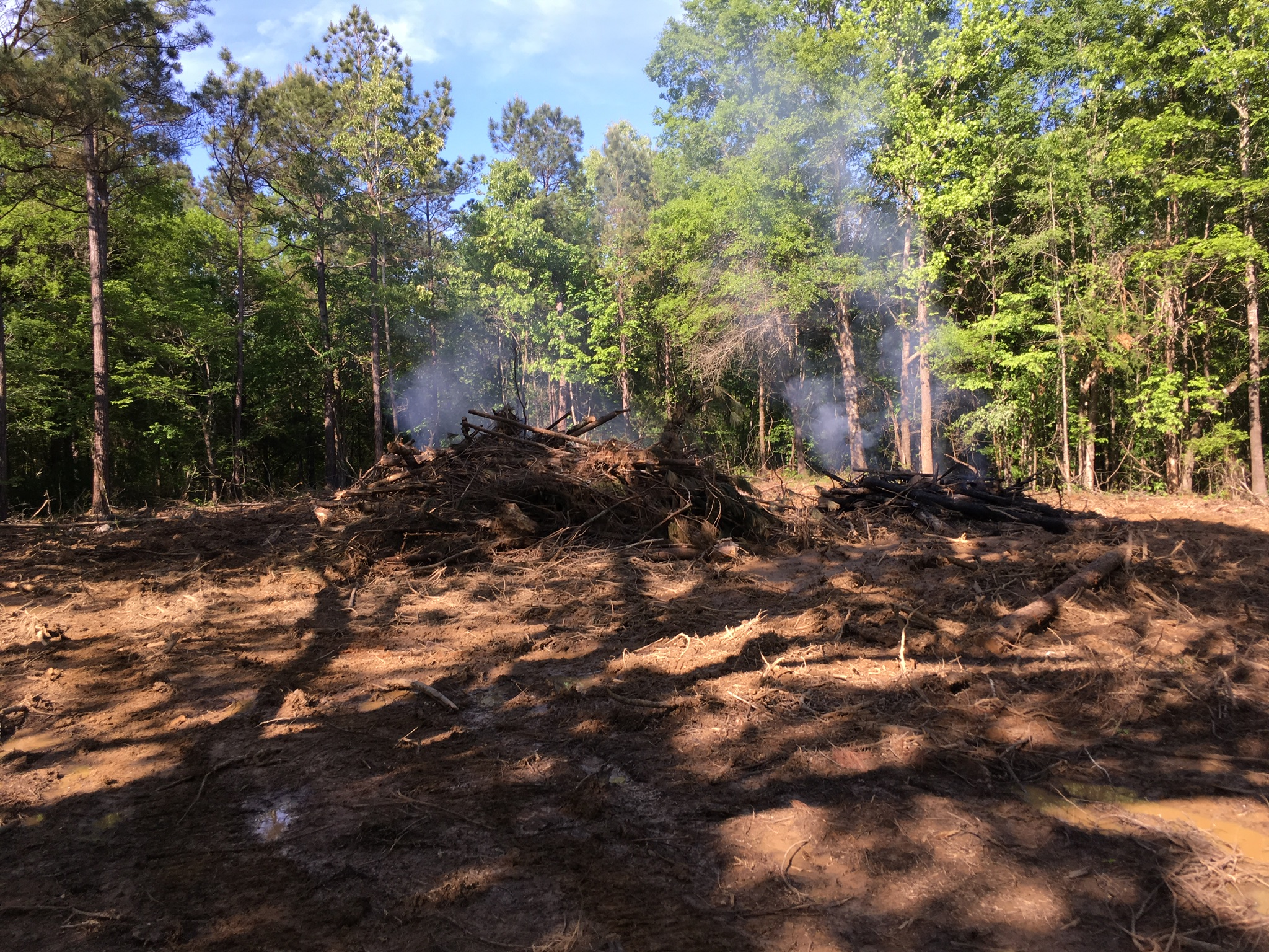

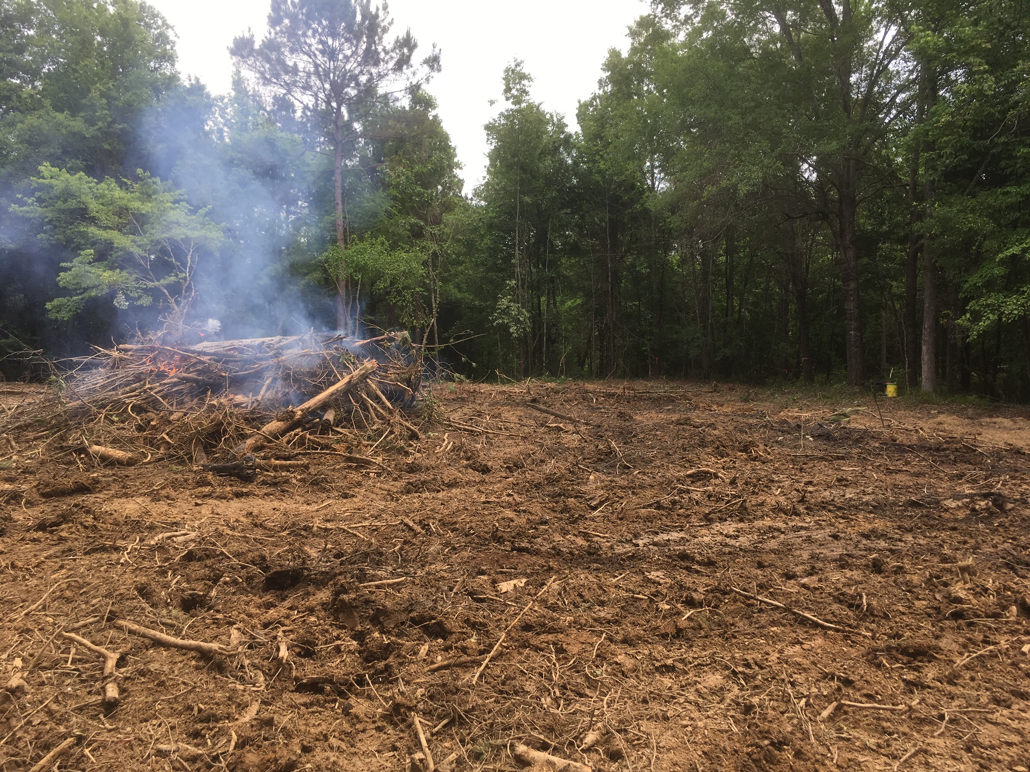

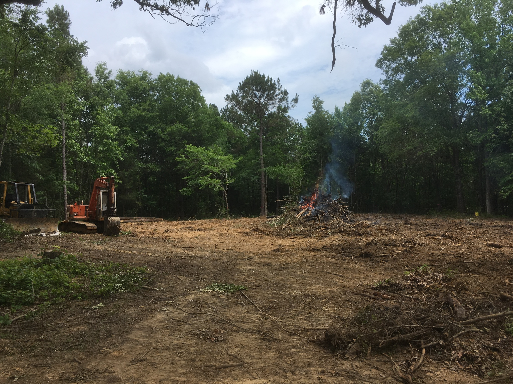

Hey yall. I am trying to clear some land to build a home on. I have gotten rid of the bigger trees and stumps but have a bunch of annoying small trees 1 and 2 inch trees that still need pulling up. What tool have yall found to work fastest or most efficiently to remove small trees?
How would a ratchet rake do with this vs. spending $1800 on a root rake for the dozer?
I have a rock grapple bucket on FEL and box blade with extra long rippers on the 4110 mahindra now. Both of those are helpful.

Update: Thanks to all who have replied! I bit the bullet and bought a root rake for the dozer. I borrowed a landscape rake from my brother to pile up some loose sticks and saplings. There still remains quite a few saplings with attached roots so as soon as I can get my welder out there and weld the brackets on I’ll get some update pictures.
