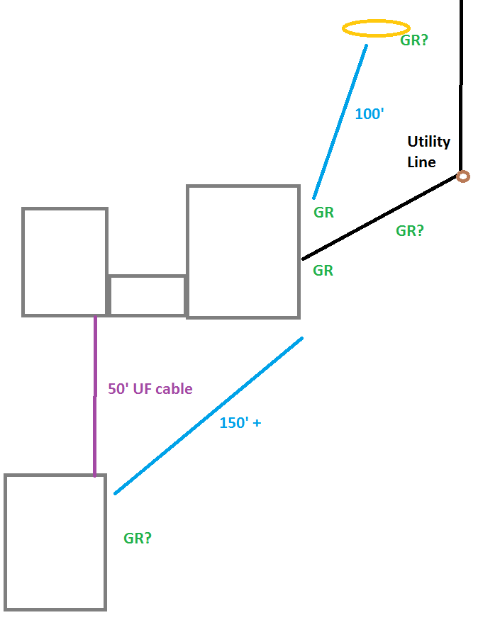

I have two ground rods within 5' of the house, 10' apart, connected with #6 THHN. Closest rod is connected to panel with #6 solid.
Shed/Barn out behind house has a 12/2 UF for power for some lights and general outlets. Planning on changing that to 10/2 at some point. Ground is provided that way, no separate ground rod.
LP tank is 100' from the house, out by the road. Gas line is poly/plastic, so no ground connection via pipe.
Considering a third ground rod at the house, but do I want it in a straight line from the others along the house? Or should it go out, away from the house, forming a T or L?
Do I need a ground rod out by the LP tank since it uses poly pipe and is not tied to any existing ground?
Do I need another ground rod at the shed tied to the ground of the UF?
Sketch is NOT to scale.

there is no requirement to add a 3rd ground per nec. you should not have separate derived grounds, it causes more trouble, all grounds should be tied to the same point, if they are all tied to the same panel.

For power supplied from one source all the grounds and neutral must also come from the same source. For example, I recently installed and had inspected a generator transfer switch/breaker panel combination. I passed the inspection. So now I have two load centers, AKA breaker panels. For the second panel I had to not only bring power from the main panel I also had to bring the ground and neutral. The second panel supplies power to some of the house circuits but also powers a structure a couple hundred feet from the house . To meet code I had to run the power wires, plus the neutral and ground, out to the structure. The structure has 240 volts as well as two 120 volt circuits. I could add another load center in the structure but the ground and neutral would still need to come from the main panel at the house. The inspector from the state quizzed me on the ground and neutral wiring and told me this was one of the most common mistakes he saw, having separate grounds but not separate power sources. So you don't need another ground rod. If the building was metal you could ground it with another rod but then you would need to make sure it could never be connected to the same ground as your wiring. If you do run new wires to the building you will need 3 wires for 120 volts and 4 for 240 volts, one of those wires being the ground and one being the neutral.

you do not need to ground a propane tank. you also do not need to set a ground rod at outbuilding if its fed by 2 or less circuit (ie uf cable). as you do not need a panel in an outbuilding if there is only 2 or less circuits feeding building.
if you install a breaker panel, at least where i work, you have to feed that panel with 4 wires (2 hots,neutral and ground) and you need to add a ground rod tied onto incomming ground wire. the new panel would be required to separate grounds and neutrals.
but since you dont have a need for a panel, dont worry about any of this.

The 12/2 UF (w/ground) goes to a two space panel with two 15A breakers, so there is only 120V out there. That's just really to allow me to turn power off out there if I need to do anything. I have no need for 240V.
When I change and run 10, I may go ahead and use 10/3 UF (w/Ground) just for future. But that will still all be tied to the existing two ground rods as all of the ground wires are tied back there.
The notion of a third ground rod is as much for lightning or other faults as anything else.
I wasn't sure about the LP tank though.

He’s only running 15 amps, not 30. He’s not combining the circuits. The wire size is fine.

Think I'd put a ground by the LP tank. There's a ground by our generator and also at each building: house and carriage house.
   / Grounding Questions, Electrical #10
Generators should not be grounded either. Generac did away with grounding generators about 10 years ago, the grounding was done thru the ground wire run to house. Too many separately derived grounds are not a good thing.
multiple ground rods HAVE to be tied together, and actually are not desirable.
I have never seen anyone ground a propane tank.
