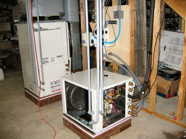

Does anyone know a source for a ground water heat pump that has a separate outdoor unit and a indoor air handler.
   / Ground water Heat Pump Question #2
There are two general styles available. You can get a unitized unit that has everything, compressor, air handler, etc in one box. It is slightly bigger than a normal air handler with external connections for the water loop. You can also get a split to connect to a separate airhandler. It is smaller and has water and freon connections. ClimateMaster also makes a split unit that is designed to be mounted outside to replace an existing condenser unit. Be aware with a split unit, you should replace your existing airhandler to a newer unit properly sized and meeting the newer high SEER ratings. If you use an older airhandler, you may not get the expected efficiency.
In the attached picture you can see a unitized unit and a smaller compressor unit for a split, which are part of my installation.

I just upgraded a couple of years ago to a 14 seer variable speed AH and I was hoping I could use what I have. I doubt I'll ever get any payback by this type of change over.
   / Ground water Heat Pump Question #4
Should be fine. You will need a TXV if you don't have one.
