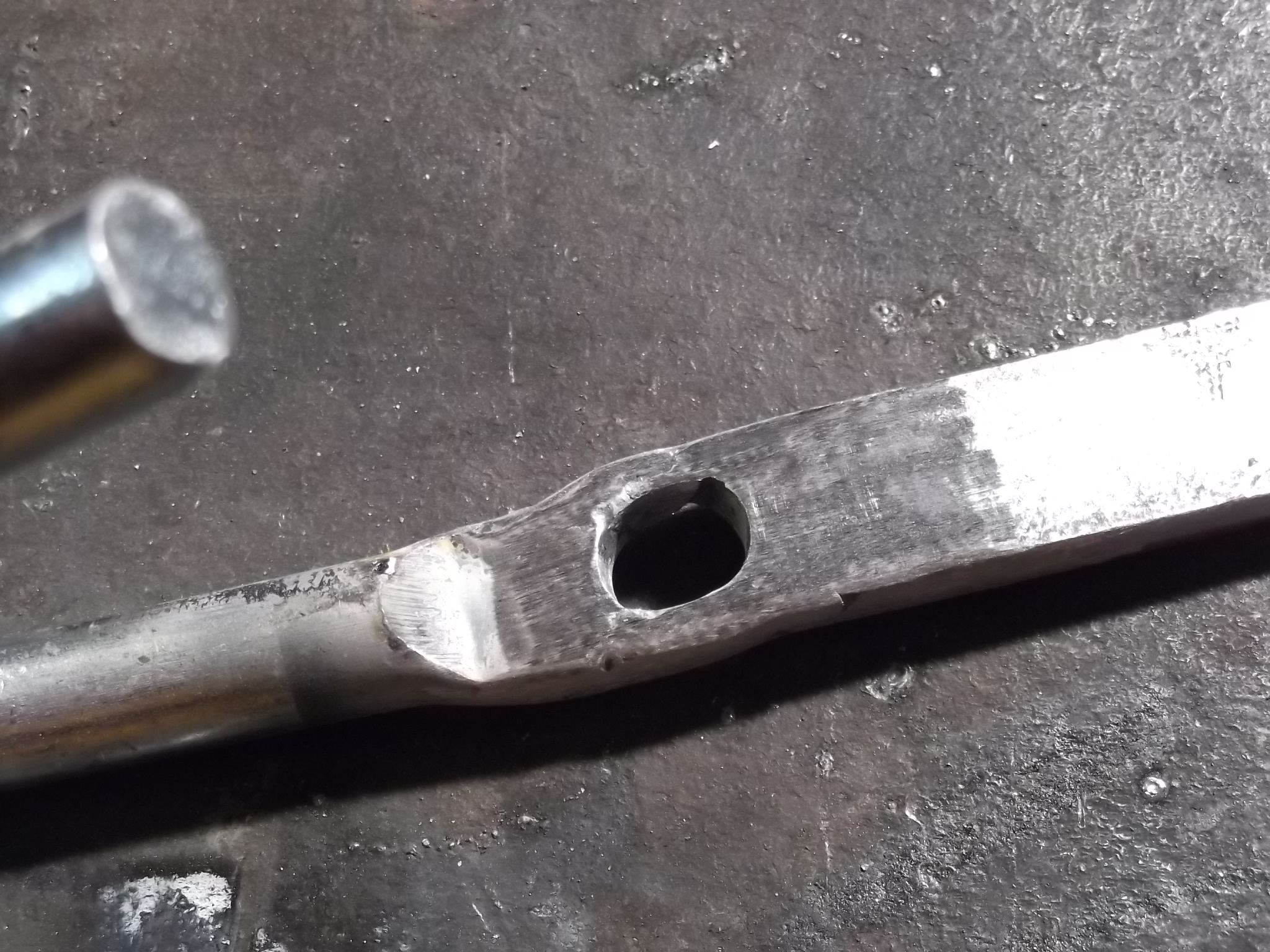

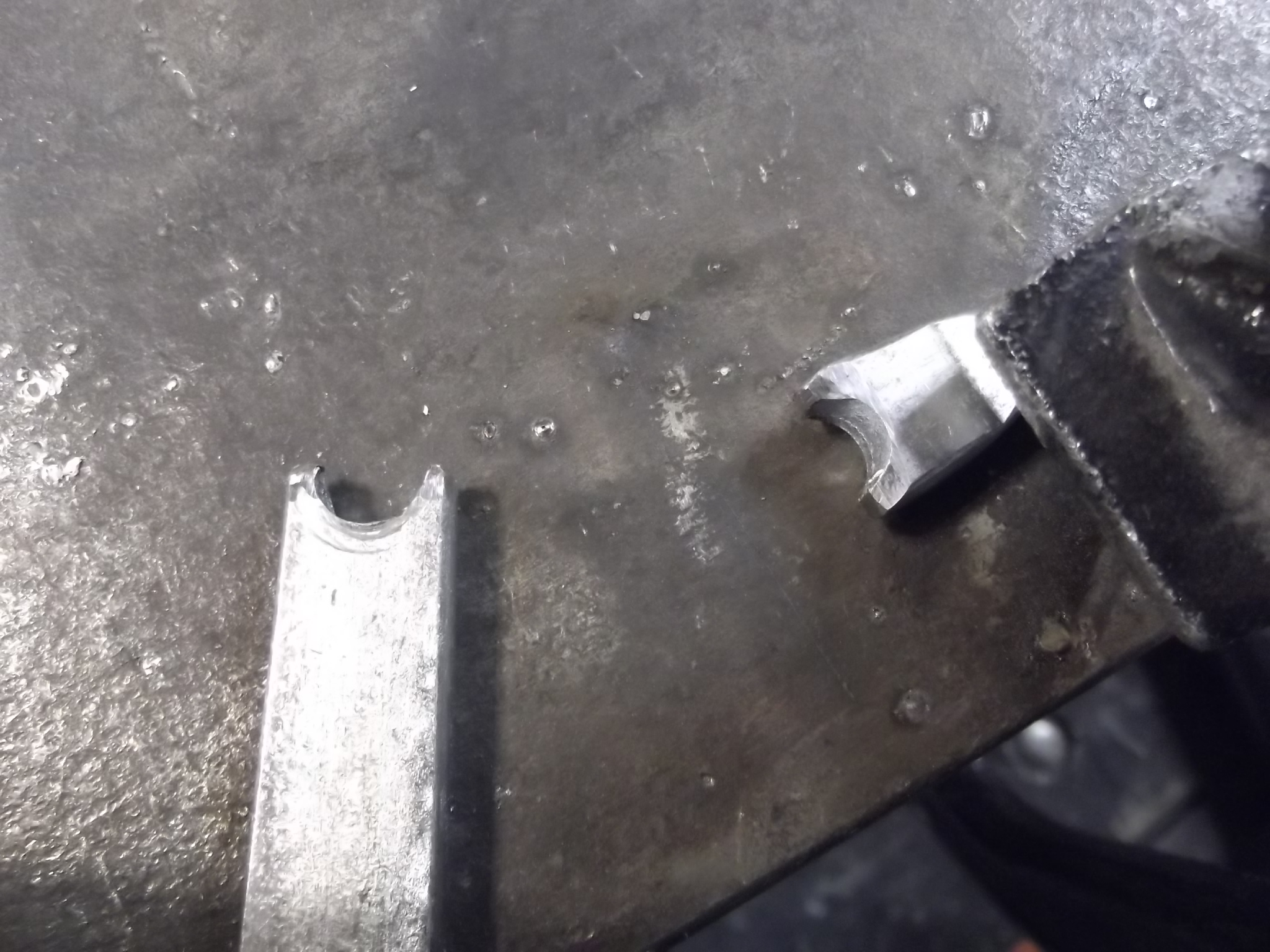

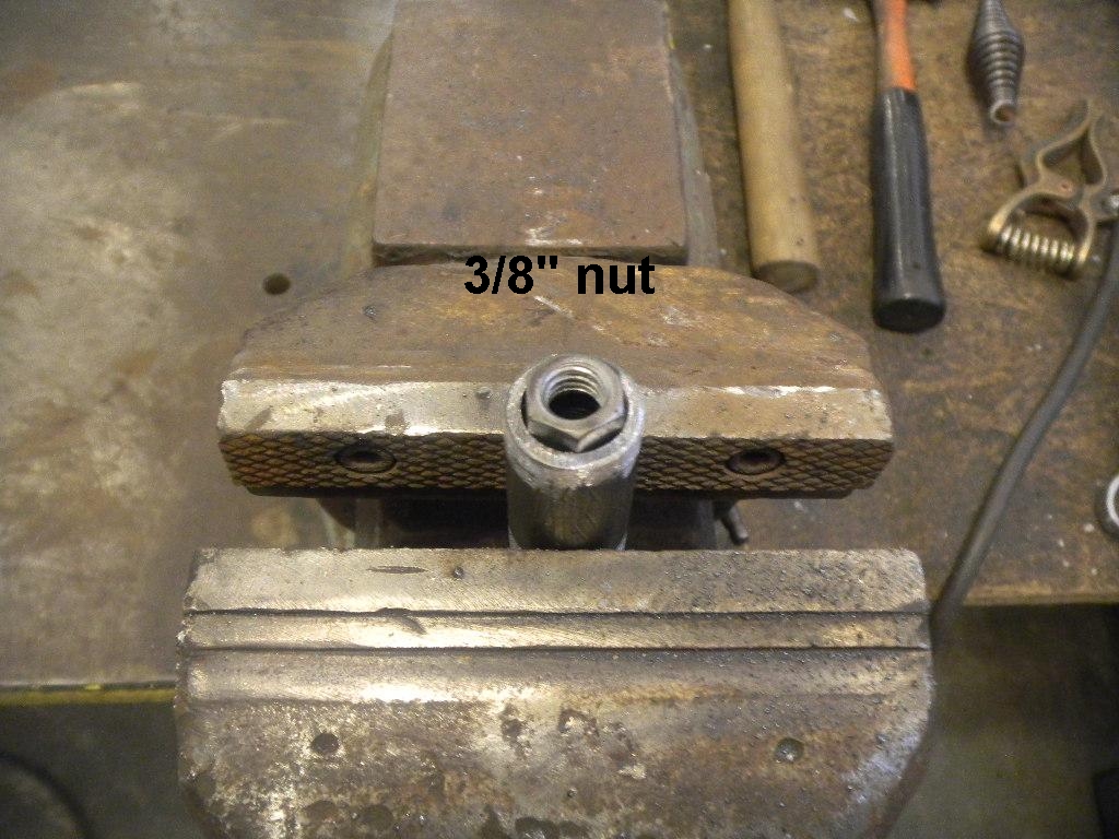

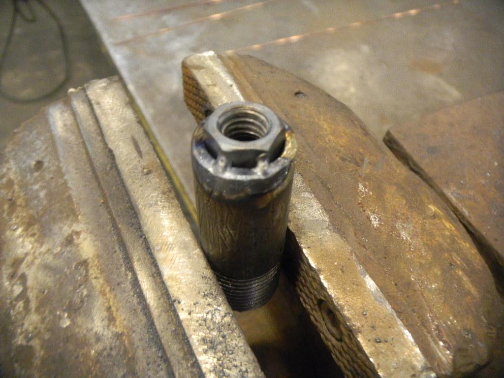

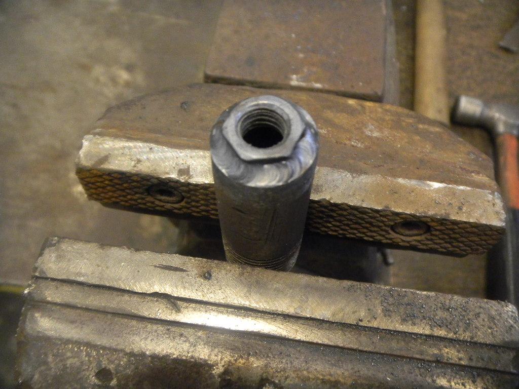

A Tig welder is very handy to have. Especially for small objects!

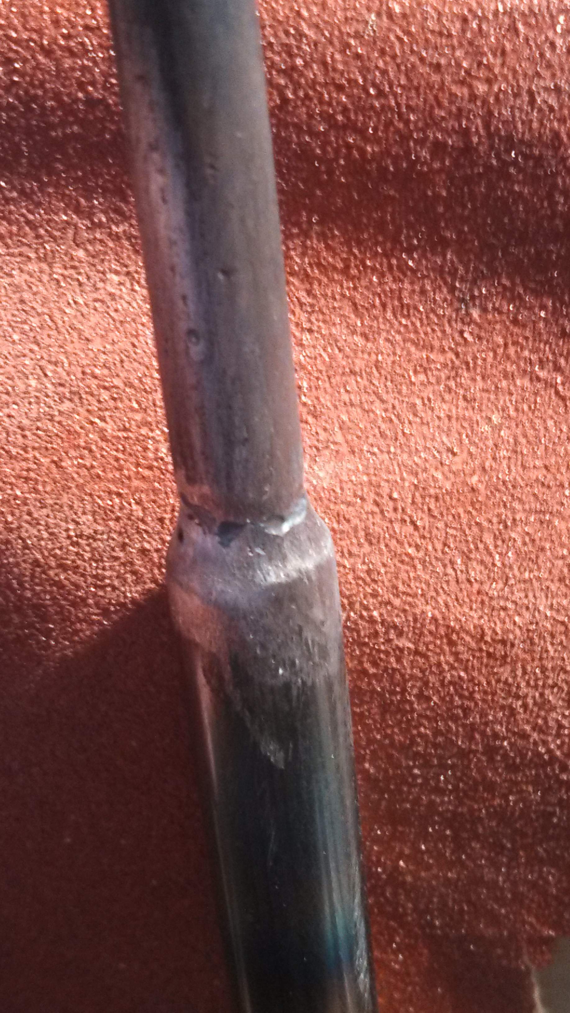

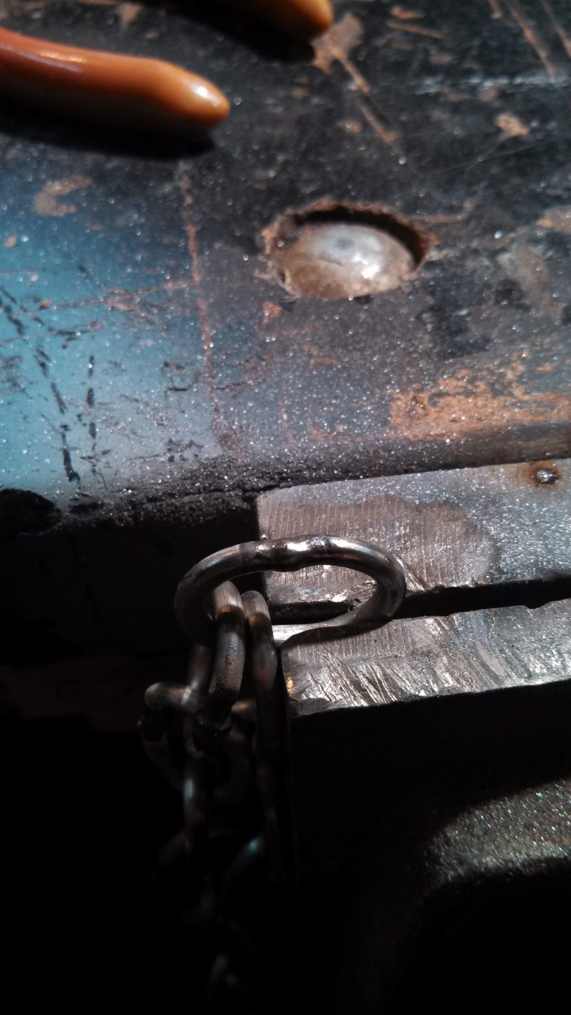

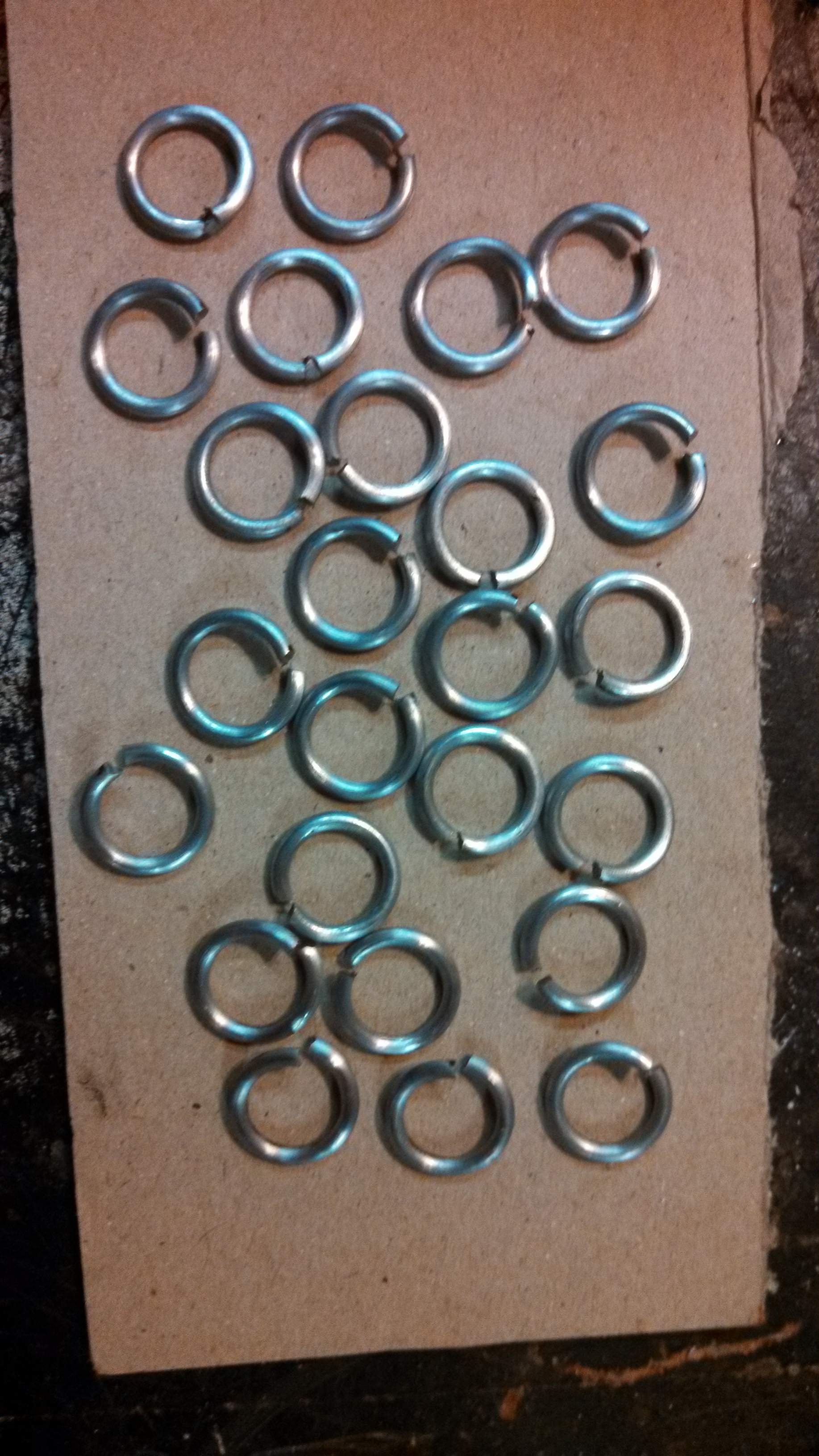

Tig is usually pure argon. In the old days they they used helium, hence the term heliarc. Tig is a great thing to have. Especially for thinner materiels and delicate things. The heat affected zone is fairly small. You can also do things like brass and copper with TIG. TIG does require skill and practice, but if you master it, you will really enjoy the control that you have. It is quiet, clean, and it is all up to you.
   / Grizzly H8153 TIG/Stick welder - Anybody ever heard of this? #10
Tig is usually pure argon. In the old days they they used helium, hence the term heliarc. Tig is a great thing to have. Especially for thinner materials and delicate things. The heat affected zone is fairly small. You can also do things like brass and copper with TIG. TIG does require skill and practice, but if you master it, you will really enjoy the control that you have. It is quiet, clean, and it is all up to you. Here look at these copper "crush washers" I tigged together from 10 ga. copper wire. Nothing special, but I needed some copper crush washers, so I just made some. this is something you can do with TIG. You can't do that with stick, you can't do that with MIG, you could do that with gas if you were really really good, but with TIG it makes little delicate weld jobs easier.
You can make little chains, you can fix little broken brackets that I just couldn't find a new one of. And other ridiculous mending tasks.:)
