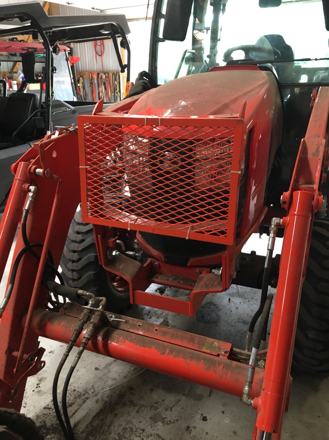

I got a new L3560 tractor and it has a factory grill guard. I feel this guard is not up to my needs so I’m either going to add some expanded metal to the existing guard or I’d prefer to buy the panels if they were available (like the deluxe kit on a JD). I do a considerable amount of work with a grapple.....and I feel you are inviting problems when that grill is not better protected.....than offered by the factory guard. Maybe Landpride will make a "kit" someday? Hint....Hint!
In the meantime....I noticed an old camping grill was just about the perfect size to cover a portion of the grill. So, I just cut off the supports, painted it orange and zip tied it to the existing grill until fall when I can get a proper grill fab’d.

Oops. ^ Forgot to ask the question: Has anyone got a Kubota Grill Guard Fabrication that they are proud of?......so I can copy the design. Or....better still does anyone offer an improved kit for the Kubota? Thanks for any good suggestions.

I'd put on some more zip ties, carry some spare wire and monitor it until a tie broke.
Looks good as is.

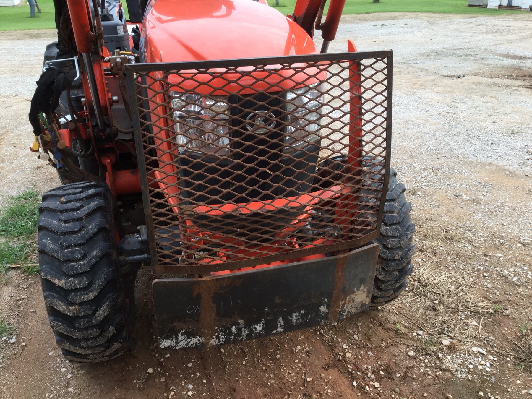

We made our original grill guard out of expanded metal, but finally tore a hole through it, taking out a head light. Replaced a large portion of it with 1" floor grate material. So far, so good.
   / Grill guard - temporary #10
Still needs painted and it’s nothing fancy but after extensive brush and grapple work and replacing and upgrading the bottom part for a 3rd time its works great. 1/2 thick by 12 inch tall bottom section hangs down quite a bit to help prevent those low lying branch sneaking under. All of it hangs out on the sides as much as I could and still not interfere with front end loader.
Keep in mind you need a bit of gap between top and bottom so you can still tilt the grill to open the hood.
