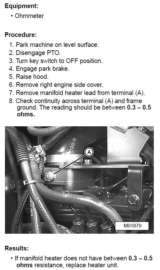

In the Tech Manual for my 955, there is a detailed diagnois process for the engine air heater circuit and control module. If all of that checks out, the manual simply states "Check air heater" with no further instructions or info. I looked through the manual in several places and do not see any specs and info on checking the air heater itself.
I was hoping to find some resistance specs on it or some other way of checking it without having tear stuff apart. I guess there may be a chance that I can remove the air inlet hose and may be able to see the heater element to check it.

I would suspect you should have near zero resistance if checked with a ohm meter, that's the way glow plugs are. I can't believe they dont put a value in the manual :confused: but one things for sure, if it's open (infinite resistance) then it for sure won't work.
   / Grid heater test #6
While nothing in the 955 manual, the 4x00 tractors use similar or same device. That manual shows 0.3 to 0.5 ohms. So like Kenny said, near zero ohms.

As suspected, the easiest way for me to check it was to removed the air inlet hose and just look down the neck. It actually looks more like a ribbon about an inch wide, standing on edge and folded back and forth many times. A jumper wire from the postive battery terminal to the heater stud was all that was needed.... the heater glows bright yellow-orange. My control module, however is toast.
