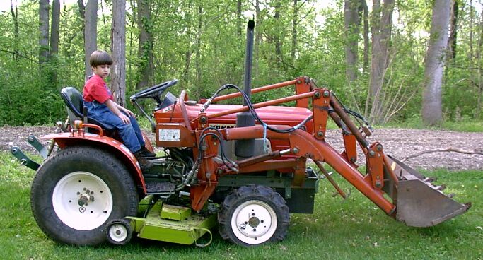

Guys,
I finally managed to borrow a digital camera and take some pix of my YM1301D with loader and MMM. Check them out on my web site <A target="_blank" HREF=http://www.geocities.com/gregbirkymustang/>http://www.geocities.com/gregbirkymustang/</A>.
I attached one to whet your appetite! Enjoy the pics!

Greg,
Where did you buy the PTO kits, and how did you mount the belly mower on your beautiful YM1301D?
Thanks,
Paul
   / Greg's YM1301D w/loader and MMM
Re: Greg\'s YM1301D w/loader and MMM
Paul,
I bought the mower with the electric clutch from a Yanmar dealer. Mounting it required me to drill a couple of holes in the frame in front of the engine block to mount the plates for tensioner and idler. Although there were already holes in the front bumper, they were not spaced correctly, so I also had to drill holes there to mount the clutch. The deck is attached to the tractor with 4 bars. The front two mount to the plates that hold the tensioner and idler pulleys. The back two I attached to my loader frame.
It would be just as easy to run the mower from the rear pto. For a powershift tractor that would work very nicely. But since my 1301D isn't powershift, the rear pto only runs with the clutch out. That means that anytime I stop to shift gears, the deck would stop. The electric clutch eliminates that problem - and since I already had it, I decided to change its location to under the hood. I got that idea from a YM187D I saw at a yard sale last summer. Its almost done - but I'm also trying to get a YM1110D ready to sell, and thats taking my time as well. I hope to get it all done by this weekend.
If you haven't taken a look at my web page, check it out. I'll try to keep it up to date.
Greg

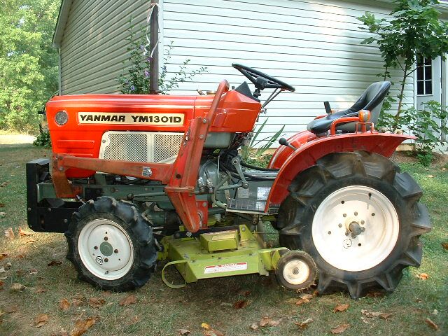

I finally got the Michelin "turfs" on my YM1301D and got the MMM changes finished. I attached a photo of the finished product (minus painting the new brackets etc). The only thing left (besides painting) is to fabricate a new subframe to go from the loader to the rear differential.
I hope to get the photos posted on my website somtime soon.

Great looking tractor! I am jealous. You have done a great job on it. I really like the front PTO so the rear is available for tilling. Let me know if you consider selling it.
