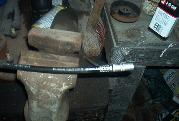

Hopefully you have a screw in zerk. A square shouldered easy out ought to do it. I believe there are metric fittings, specifically, British Standard Pipe. Since you didn't mention the fitting having a hex head on it to use a wrench on I'm thinking you have a press in zerk. Those can be a PITA. Your best bet on one of those is finding a screw you can thread into it and a slide hammer to knock it out. I've also heard of people threading them and then running a nut up a bolt that will fit the threads and then using a bigger nut and washer as a puller. You drop the washer on the bolt up against the threaded on nut, drop the bigger nut on the bolt and then thread the whole mess into the threads you've previously cut into the broken off zerk. Then you tighten the small nut against the washer and big nut, pulling the zerk out as you go. The big nut has to be big enough for the butt of the zerk to fit into as it's being pulled out. Clear as mud? The end of the grease gun fitting is threaded onto the fitting that screws onto the pipe or hose. The next time you grease, loosen the tip a little to make it easier to get on and off the zerks. If you have a plugged zerk you can always loosen the tip to install it on the zerk, tighten it once it's on so you don't push it off or have the grease run out the sides of the connection and then loosen it to remove. I ran out and took a couple of pictures so you can see what I'm talking about. This ought to save you from breaking another zerk.
   / Greese Gun Tip #5

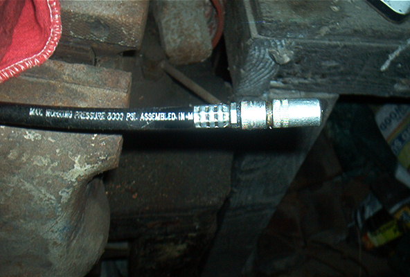

The first attachment shows the tip in the tightened position. This next attachment shows it unthreaded. I did it this way in case your tip was tighter than finger tight, we wouldn't want you loosening the whole mess! /forums/images/graemlins/laugh.gif Don't loosen it much more than you need to facilitate plugging it onto the zerk, there are little jaw- like parts in there that have a tendency to fly out and into hidden places if you totally unscrew the tip.
   / Greese Gun Tip #6
They look just like valve stem keepers.
   / Greese Gun Tip #7
The ring thing in the grease gun tip that "grabs" the zerk breaks in mine every other month. They sell them in auto parts stores for a buck.
Unscrew the gun tip and the broken one will fall out. No biggie.
