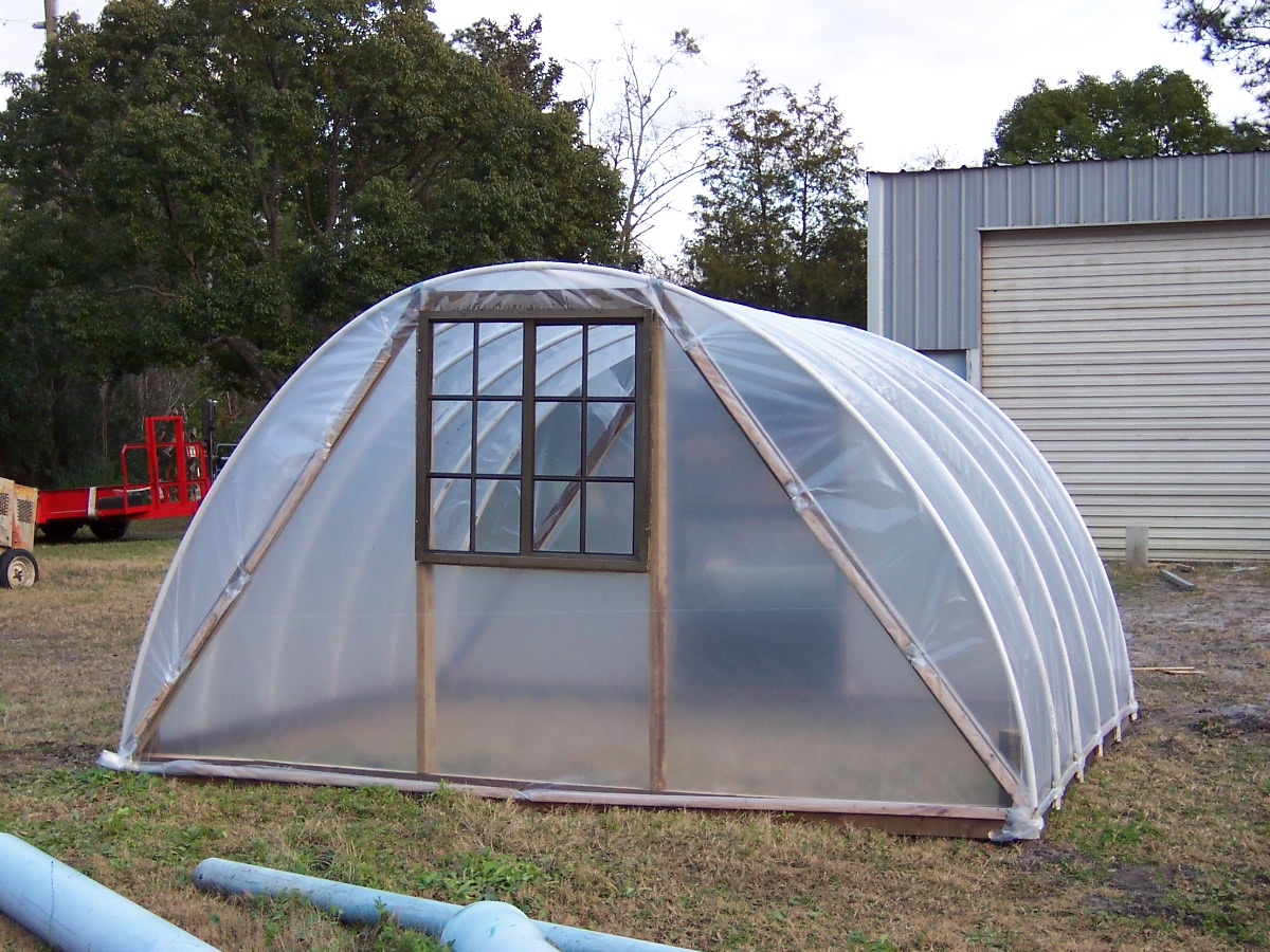

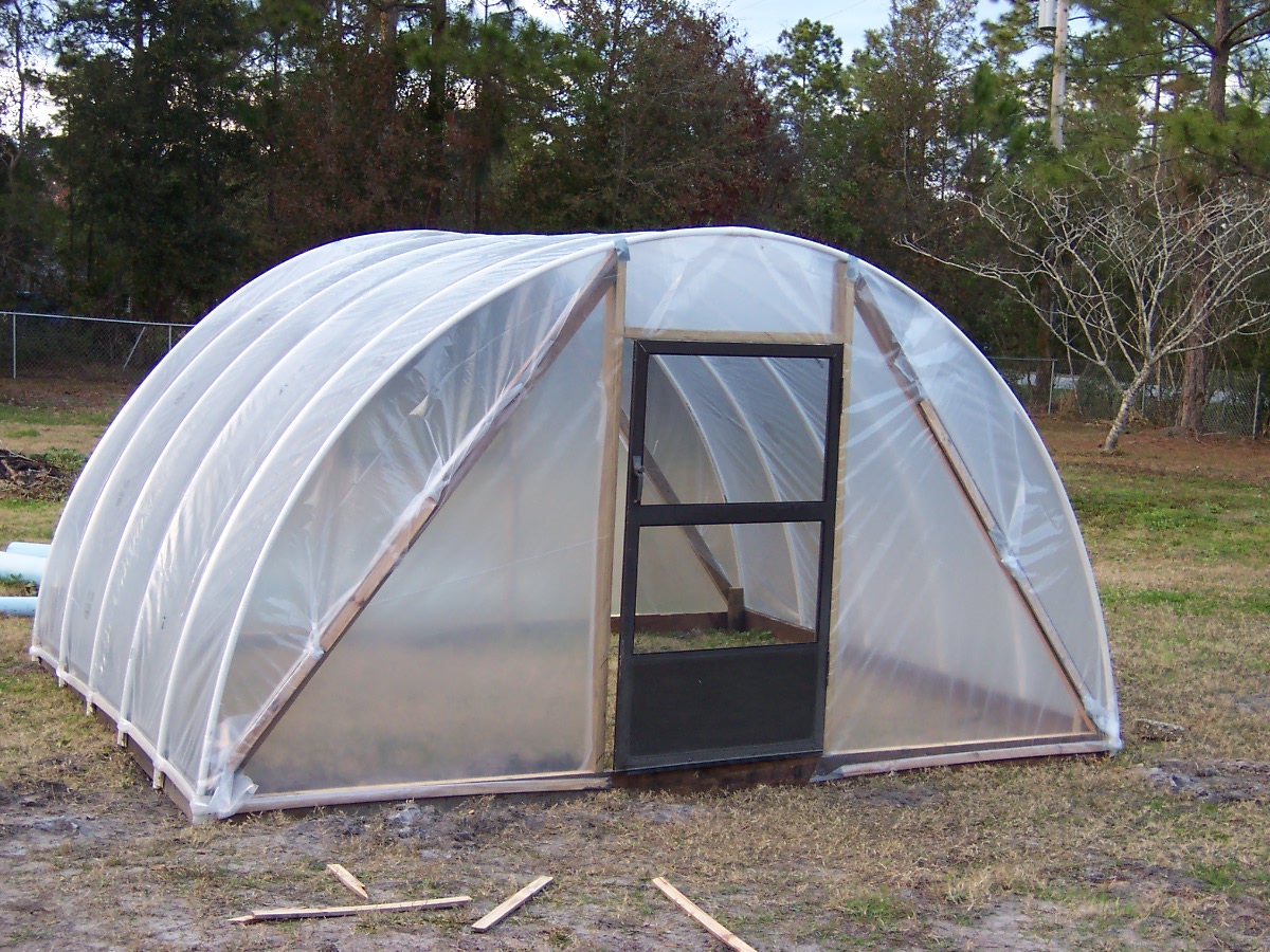

hunterridgefarm posted greenhouse plans, http://www.tractorbynet.com/forums/...8d1231956078-garden-time-small_greenhouse.pdf (Thanks)
Here are my results and observations- I built 12' X 10'. I used treated lumber that I had laying around. The PVC was about $30. a piece of 6 mil uv film 22' X 24' was $74. delivered. I cut down an old screen door that I was going to scrap for the aluminum (I have to make removeable film panels for it), also a 3' X 3' window that I mounted sideways so I can open it for ventilation in the back wall.
I probably have 10-12 hours in it. I used wood battens to wrap the film then nail for more strength. Putting the film on was a PITA, trying to make it tight on the rounded ends was a challange.
All in all I am very satisfied with it and the film is warrantied for 4 years. Now I have to start my spring plants!

Nice job. I plan to put mine up the end of Feb. This design is a good starter and we were looking at a site this weekend. I have been checking the site I want to use to make sure it gets enough sun early morning and late evening. I plan to put in a large greenhouse in the next year or two but this design will work till then.
How tall is your door?

The door is 5' tall. I was going to put a vent to open above the door so I made it shorter. Then I found the screen door and figured out that I didn't need the vent.
I had some old (solid) wood fence posts that I placed in each corner about 2' deep to anchor it. At first I figured it didn't need to be very level because the ground is pretty close but when I went to frame the door I realized it did need to be level to look right and for the door to fit. I was only a couple inches out so it was easy to get level.

Looks good -- film is good for 4 years -- what about the pvc? won't UV make it brittle and break? I've thought about using it ....if you paint the pvc it helps keep the UV from making it brittle too soon....
   / Greenhouse Build from Plans found on this site #9
When I built my hoop house, I changed the plans a little bit and went 22 X 32, went up one size in the PVC pipe.
Shade cloth is a must after the plant emerge.
We left the door closed one summer with the fans off and the PVC sort of went in strange directions as it became way to hot.
I used double film and it is still quite good except for where a deer tried to climb the side of it. After five years the film is better than the PVC pipe due to the excess heat. The pipe has never become brittle.
