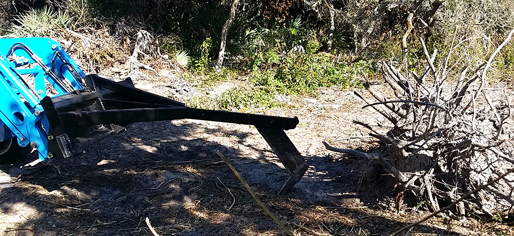

I was going to build one of these but had plans to make a 3 pt hitch type, similar to a sub soiler only with a longer reach.
I found this for sale by a tree service company that used it on a skid steer. They built it and said they spent $850 on the
metal. Heavy 3/4 " and 2" x 4" supports. I cleaned it up, repainted and added two kick stands, as the angle it lays I could not disconnect.
I added one brace and spent a day touching up some welds and sharpened the 3/4" blade. I had a root in the back that after a hour
or 2 with the bucket and a hole the size of a small swimming pool i gave up and covered it back up. I put on the stump killer and
to my amazement in less than 5 minutes it was out and it was huge. With a tool like this all the energy of the tractor is concentrated
on a much smaller point than the bucket. Have taken out several large stumps that I did not even want to try with the bucket. Much
less strain on the tractor also. You just draw it across the stump on all sides which cuts the roots and then the foot hooks on and pulls
it out in a fraction of the time and no big holes . I sound like a salesman but it is not for sale!
It works awesome on my little 38 HP , I can only imagine on a large machine, wow.

Good looking tool. I my self would rather it be on the rear of the tractor as the rear is designed to pull. I would be concerned about damaging the loader arms. They are designed to push and not so much to pull.
   / great stump removing attachment #3
I like it. Being out front you can reach under low limbs that might hinder you with a rear mount. I don't think you could get enough traction to damage the arms and as long as you move straight back and not try to turn, I think you will be ok with using it. Turning might tend to warp your FEL lift arm but otherwise I think it would not be a problem.
With it mounted on the FEL, It can change the angle of the sub-soiler just like having a top hydraulic link on your 3 PH.
I agree. It isn't any more severe than using a root rake on the front. It puts very little strain on the tractor compared to using the bucket. I don't pull and jerk
anyway, you can tell when something is giving and when its not. On a bigger tractor you could even reach up and remove limbs. I do on small trees and works
fine, just have to know the limits of what your using. The tree service used it for years and said it was great for removing palmetto trees. I cuts great ditches also.

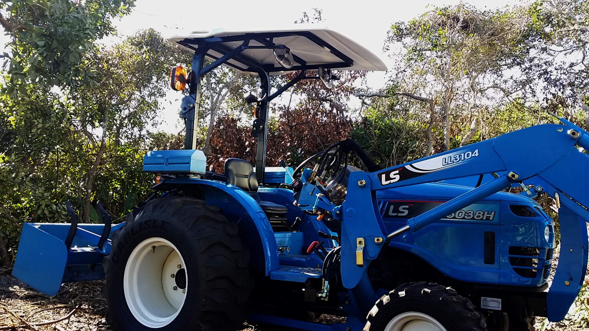

Second, you tractor is WAY too clean! :D
   / great stump removing attachment #6
I like the tool and would really like to see a thread on your tool boxes, with close-ups.
the tool boxes are from harbor freight and I welded a bracket to fit the bolts holding the rops on.

I have often thought that a frost hook on a backhoe would work well, thanks you have confirmed that for me.
