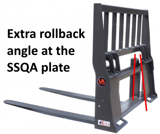

And this is what I mean about "extra rollback built in". It helps to keep what you are carrying from falling off when going downhill:
   / Great price for SSQA forks. #8
I agree that adjustable width between blades is desirable, but would not "extra rollback" be simply a mater of curling the ssqa plate?
