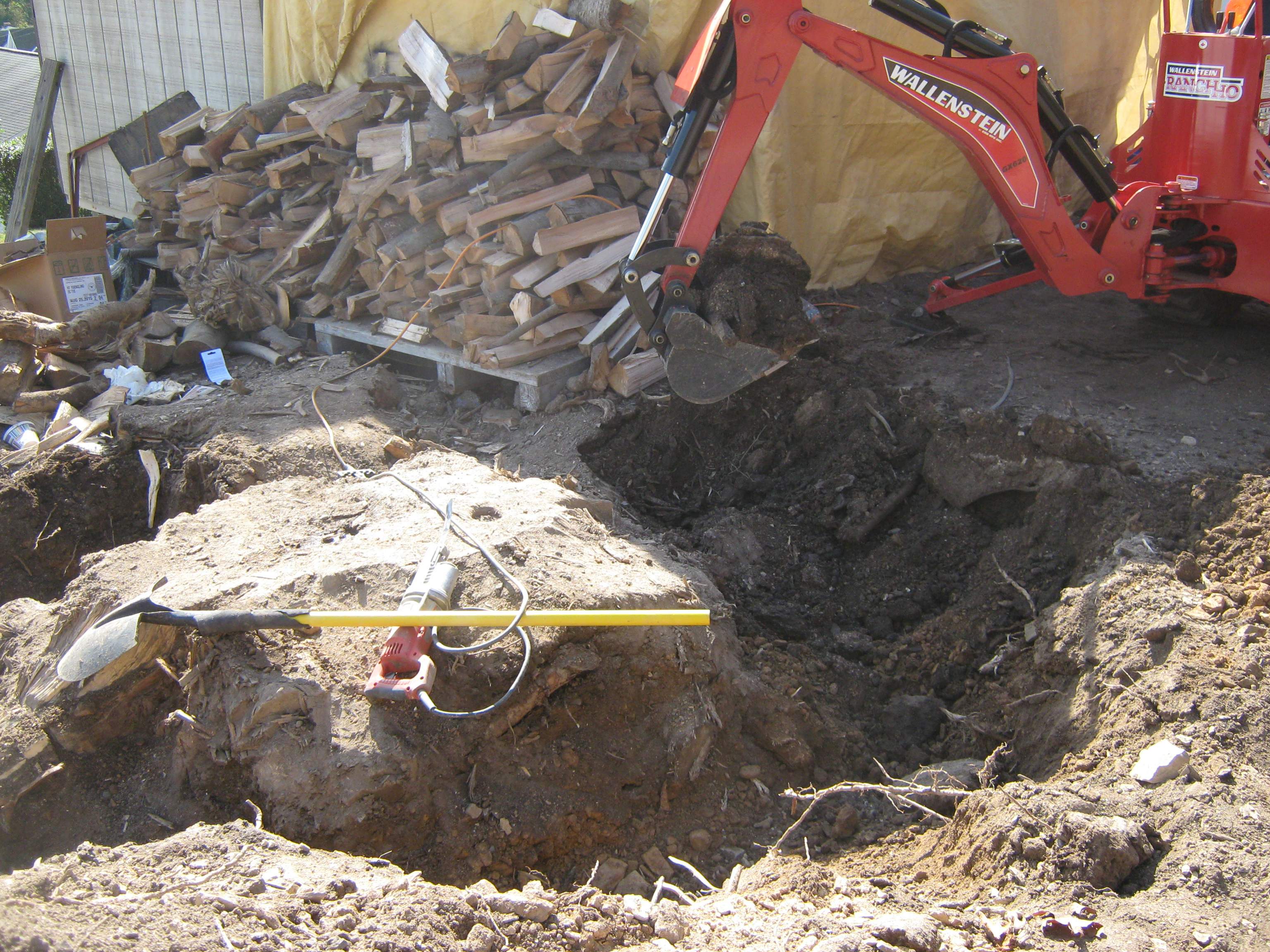

I have a Wallenstein hoe , but I have a subframe mount on it. Just be careful digging with the three point, could end up braking something. Just got done digging out a big stump with my 1423. Stump was 4 feet across. IMG_1349.jpg
   / Great Bend Backhoe Opinions & General 3pt Backhoe Questions
I have a Wallenstein hoe , but I have a subframe mount on it. Just be careful digging with the three point, could end up braking something. Just got done digging out a big stump with my 1423. Stump was 4 feet across.View attachment 446834
I'm curious what typically fails when using a 3pt backhoe?
Looks like a new unit, I am sure nobody makes a sub frame for a 340B sadly. I could make one easy enough.
