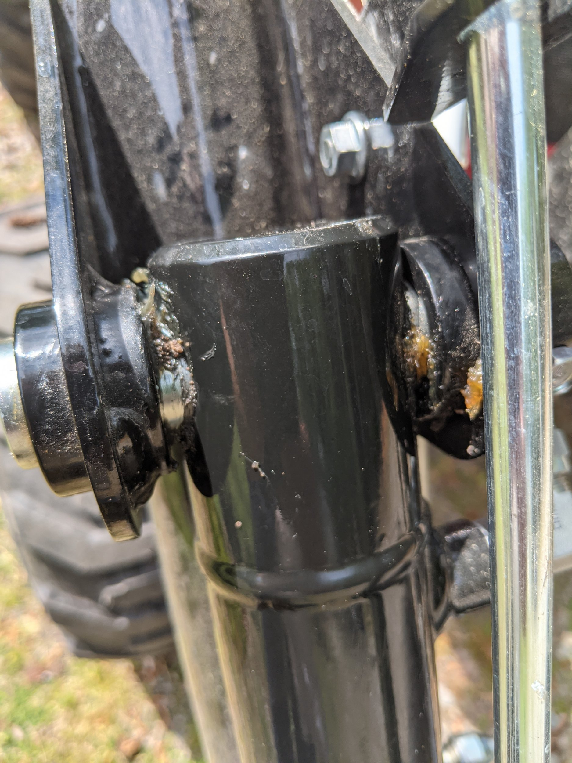

When greasing, if there's a bit of grease being pushed out of the bushing am I over servicing?
Also noticed the FEL hydraulic pistons are able to slide back and forth laterally over the mounting bushings. I've got about 35 hours on my new machine, is this normal wear as it breaks in?

You want to push out a little grease when greasing. Not a ton, but just a bit.
Some would argue that you want to push all the grease out until you see 'new' grease coming out. I think this is overkill
Be careful with sealed bearings and bushings, as you can damage the seals by pushing too much grease. You wont see the grease in those places, but you will feel resistance.
As for the lateral movement in the FEL cylinders, this is normal and is for clearance.

I push until I see CLEAN grease-that doesn't always mean it has to be new grease. Then I wipe the blobs away. This gives me peace of mind that any moisture or dust is not a part of the pin lubrication anymore. I've driven out pins by operators that were conservative with greasing and there would be areas on the pin surfaces that just seemed to not wick grease and they'd be gritty or rusty. Probably from moisture and dirt.
It's not going to look pretty but grease is a good thing to see on a pin.
