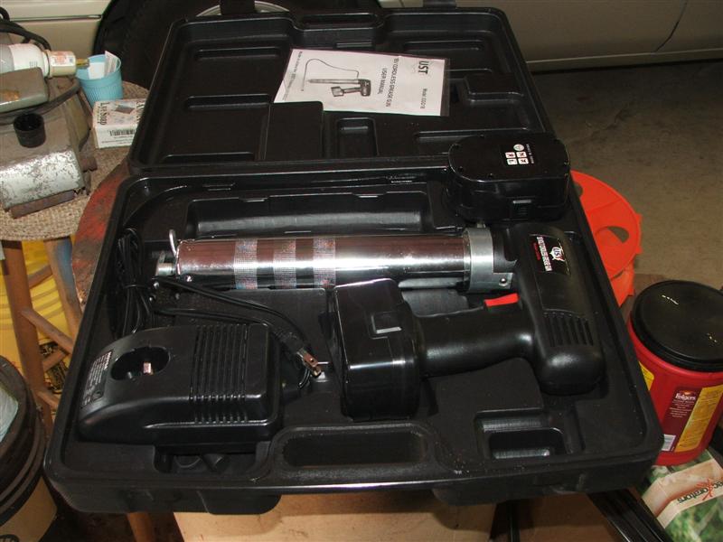

Just picked this up at Rural King yesterday, it was on sale w/coupon last week so I got a rain check, went back and they were in. I used it today, works good so far, was full of grease, had to charge the battery, no pumping, no air hose, only thing it's too big to carry around on the tractor where I have my old one. Price...$24.99 includes two batteries and charger and molded plastic carrying case. Might as well add a pic.
Rural King Farm and Home Internet Store
