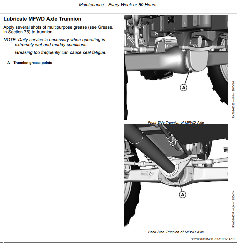

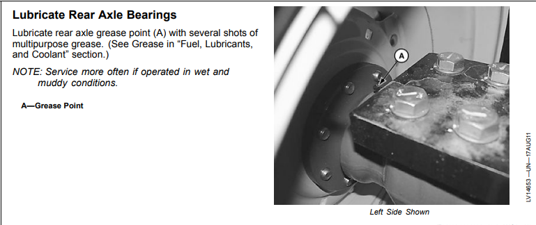

Lubrication was shown in 5085E operators that I checked.

The ones that Tx Jim show are the same ones on my 5093E, suprisingly there aren't that many.
