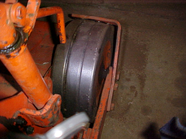

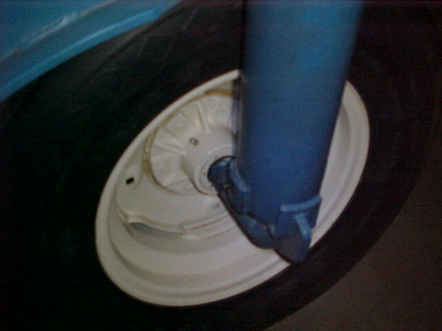

I'd drill and tap a thread in the hub between the two bearings and then fit a grease nipple (zerk?).
I've not found many bearings that don't last longer when greased from time to time, once a year should be often enough for your application.
Couple examples of my efforts attached. the second involved drilling a hole from the end of the shaft that mounts the bearings, then two holes in from the side, one to allow the grease in (nipple) and one to allow the grease out (between the bearings). Then welded up the hole at the end.
Hope the photos come out bid enough, don't know how to resize them.
