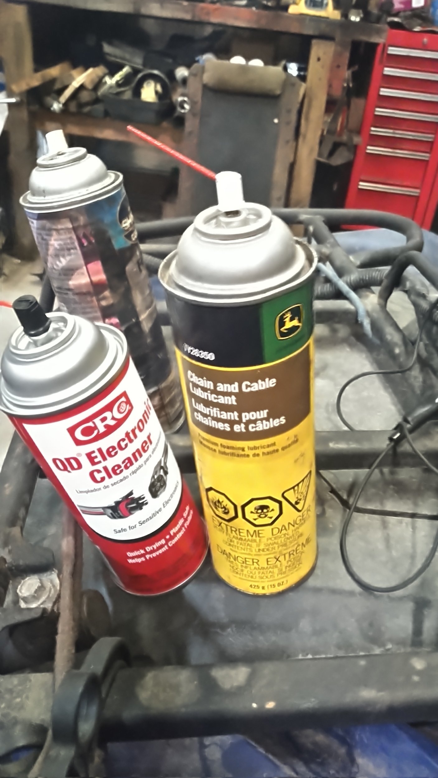

Well this free relic is over 20 yrs old and still working like a snow plow on original king pin I will say greasing open sliding components is messy and I wouldn't do it in the non snow months cuz then it's a dirt magnet. I also recommend lubing a steel cable winch somewhat frequently with cable and chain lube.
