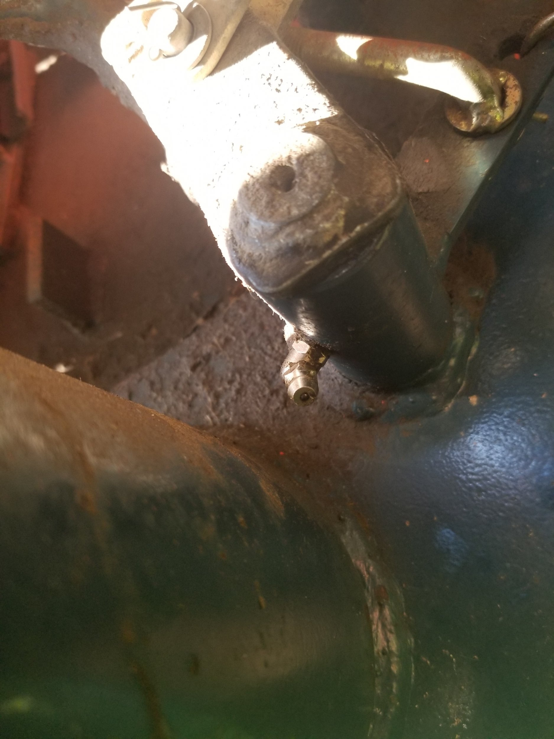

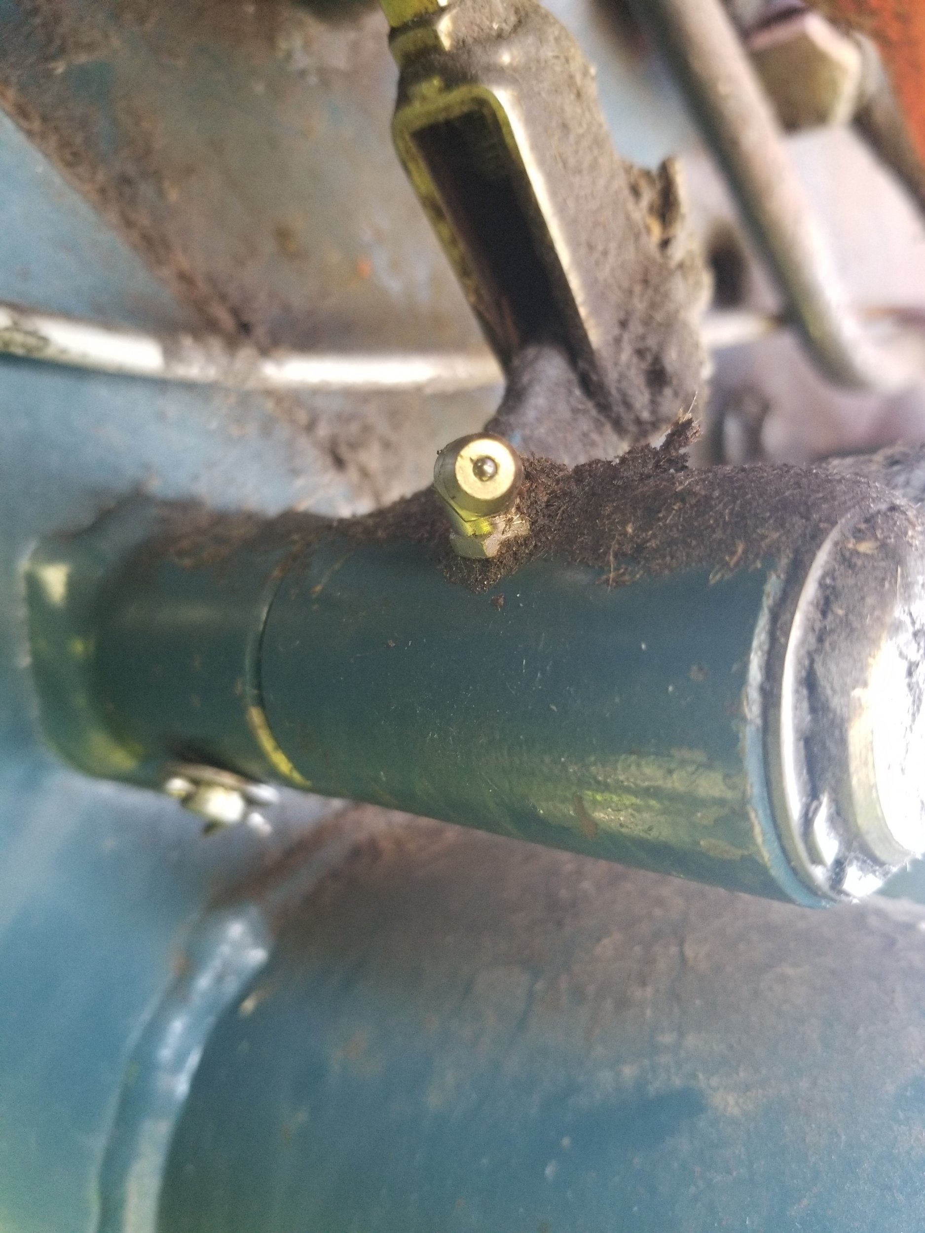

I have a 4WD Kubota B20 TL420 and am trying to find all the gease points on it. I've always greased the ones on the bucket, they were obvious. But I'm still sure there has to be more on the tractor. I've searched high and low and crawled under it searching. The only things I could find were possibly the 2 I'm attaching photos of. I found one pictured below under the clutch, and other pictured below under brake. These are both grease points aren't they?? They were so clean, which is what made me hesitate LOL. So I wanted to ask first. Also are there others I'm missing on the tractor body??

They should be in your manual. It definitely can be hard to find all of them. If there is a grease fitting like the two you show, grease em. I bought these yellow grease cap/covers from lock N lube, so once I found them all, they are easily found next time.
   / Grease points kubota B20 #3
The front center axle pivot will also have at least one grease fitting and should be greased regularly. Some Kubota's will have a pipe plug you need to remove prior to greasing the pivot and grease needs to be coming out of the plug hole as well. Some also have grease fittings on top of the outboard gearcase's (axle king pins). Every owners manuals show all the grease points. I suggest you refer to that.
   / Grease points kubota B20 #4
probably be easier to find them if you gave it a bath. Loaded with crud.
   / Grease points kubota B20 #5
Check for fittings at every pin or bushing. It will also help you learn the machine.
