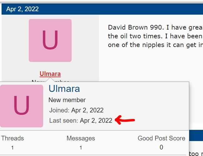

Wonder if the OP will be back?
   / grease in hydraulic oil #7
Hello Xfaxman,
It is obvious the fellow was incorrect. I am in my 50's and look back clearly and see things I have done that make no sense. My learning curve was steep. For example, as a teenager I needed to find a grease like white lithium. There was none in the shop but I found a can of belt grease and shot a little on the tool I was working with. It didn't go well. Who would have thought that a can labeled grease was not slick? Not me at 17.
