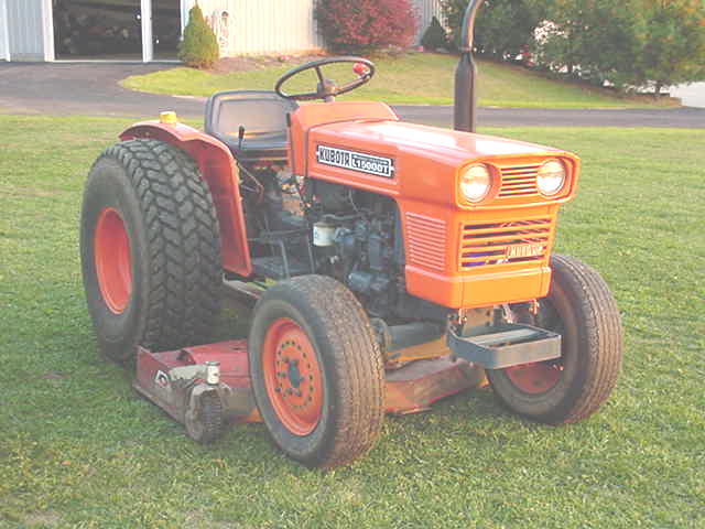

Attached is a photo of my " grey" Kubota L1500DT. I trashed the rice tires and retrofitted turfs on 6 lug implement rims (rear) and had 14" rims custom built for the front (used rims with proper offset from a dodge mini van and had centers cut out on a lathe and new centers machined and welded in at a local machine shop.) I use a 5' 3 point hitch belly mower ( they have adjustable center beams to fit different wheelbase tractors and drive off the rear pto).........Used it the past 7 years this way with no problems..........Some filters are a little hard to locate and expensive but otherwise my "grey" tractor has performed well........Tom

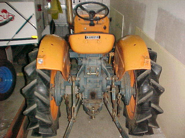

Yeah those rice tyres are "aggressive" to say the least hey !!!

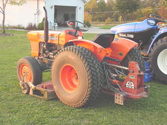

Neil......I used 13.6 X 16 tires on the rear and an automotive 205 70 14 on the front..........the big turfs made an unbelieveable difference in the ride.........Tom

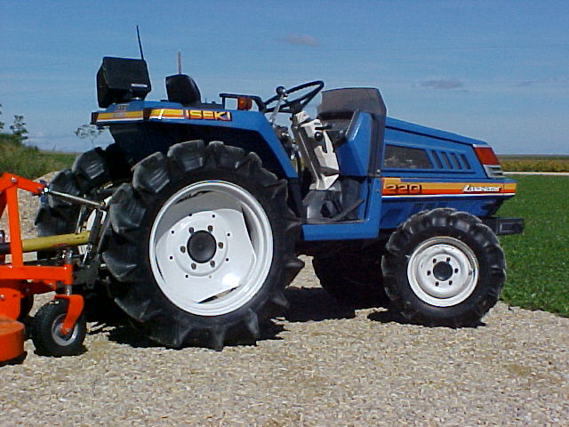

I mow my 3 acre lawn with my TU220 and a 6' First Choice 3pt hitch finish mower. I love mowing with it and have fun doing it. I mounted an AM/FM cassette radio on the fender, added a wheel spinner knob, and left my "rice" tires on. I don't tear up my lawn. You just need to mow like you were driving a tractor not a small 12hp MTD. You make larger sweeping turns, catch the backside of trimming around trees on the next pass and mow in a different pattern. With a full width rear discharge mower it doesn't matter which way I go. My wife thinks I'm nuts when I'm out there mowing a cross hatch pattern so my front lawn looks like a big league ballfield in the pros. My 3 boys think its really cool to play ball in the yard and pretend they are in the big leagues! I haven't yet wished I had turfs. Here on my little patch of the world, I play hard in the dirt, move snow, pull my neighbors out of the snowbanks, etc. and I don't know that I would be happy with the traction provided by turfs. Just depends on what you plan on doing with your tractor. Have fun, happy tractoring!
Here's a pic of my 220 with mower, check out the radio!

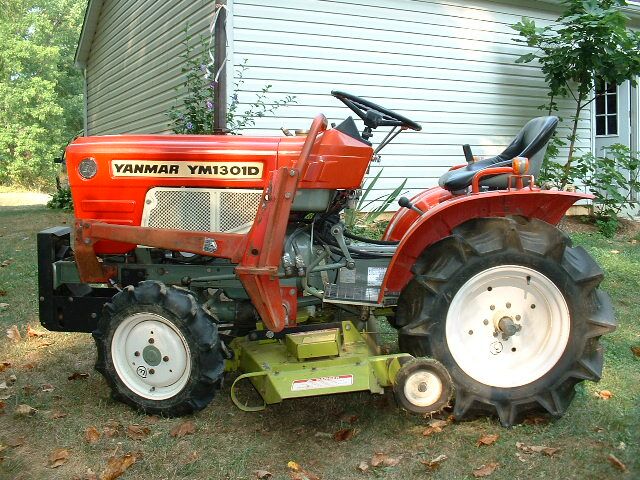

I thought I was the only one to do this.
