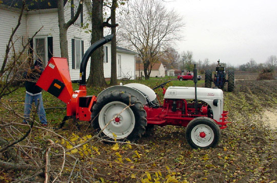

If doing limbs with allot of small growth sticking out, it can clog in the shut and slow down the gravity feed, often needing a push to keep feeding. Get the mechanical feed. The video is in the best intrest of the manufacture, they will not show you their weak points. Philip.

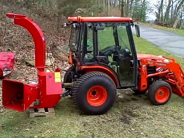

If you are not going to do any serious chipping, then you could go with the gravity feed. I would look at Wallenstein and order from Woodward Crossings in Pa. They have the lowest prices and they can freight it to a business near you.
Attached is my chipper. It is a Patu from Finland.
