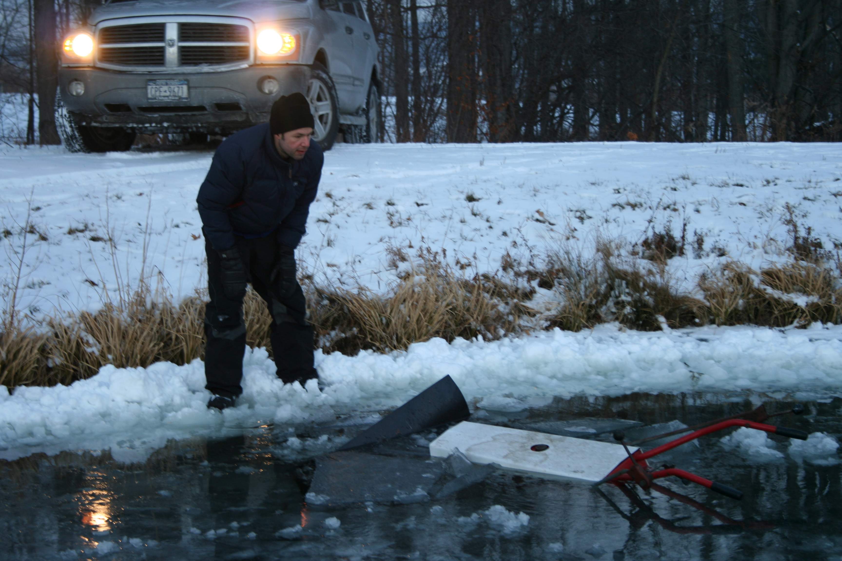

My Gravely Commercial 12 was being used to plow snow off of my pond for ice skating. Was working great by the way. Unfortunately, the ice was a bit thin near the edge from cattails, the ice broke, and the Gravely went down. See the pic. We got it pulled out within a few minutes and had the engine and transmission oil drained within 30 minutes. Later that night, I pulled the spark plug and sprayed in some fogging oil, put some kerosene in the engine and transmission, removed and drained the carb bowl, and drained all the gas. One week later with new gas (with dry gas), new oil, new gas filter, and finally, cleaned and dried points, it runs perfectly. My questions are, how long should I run it before changing the oil again? Also, is the air filter now damaged? It was almost new before the swim.

Wow.. that must have given you such a sinking feeling (pun intended).. Glad you got it out quickly and back running..
Not an expert by any means - but when to change the oil again would depending on how well you thought you got the water out the fir time.. BUT oil/lubricants are cheap so I would run it a few hrs and drop the engine oil and transmission fluid again - just to be sure all the water is out..

If the air filter got wet, change it.

If the oil doesn't go milky or froth, it's fine. The normal operation of the motor will boil off any remaining moisture in the crankcase.

Just run that gravely hard, get her hot and all the water will simply 'boil' out.
Filter, for shure a new one.

I have submerged a couple of motors over the years. Atv痴 in my younger days and most recently my deere lawn mower (GT235). I have always drained the oil/changed filter. With the drain plug removed I pour whatever old oil is laying around (the partial quarts of oil taking up space) until the oil looks somewhat normal coming out the drain. Then refill with fresh oil and let it run for a few minutes and drain. Refill with fresh oil again and run for 15 to 30 minutes and drain again. If this oil looks normal I will refill and change after an hour or so of normal operation.

oldebuttonwood: I have a Honda 110 Trailbike that was submerged in floodwater for several days in WV years ago. I did about the same process you used and the bike is still running great. I would change the oil and filter again rather soon, not so much because of water but because of whatever dirt came in with the water. Air filters are cheap and you can bet that one has some dirt in it. Good luck.
